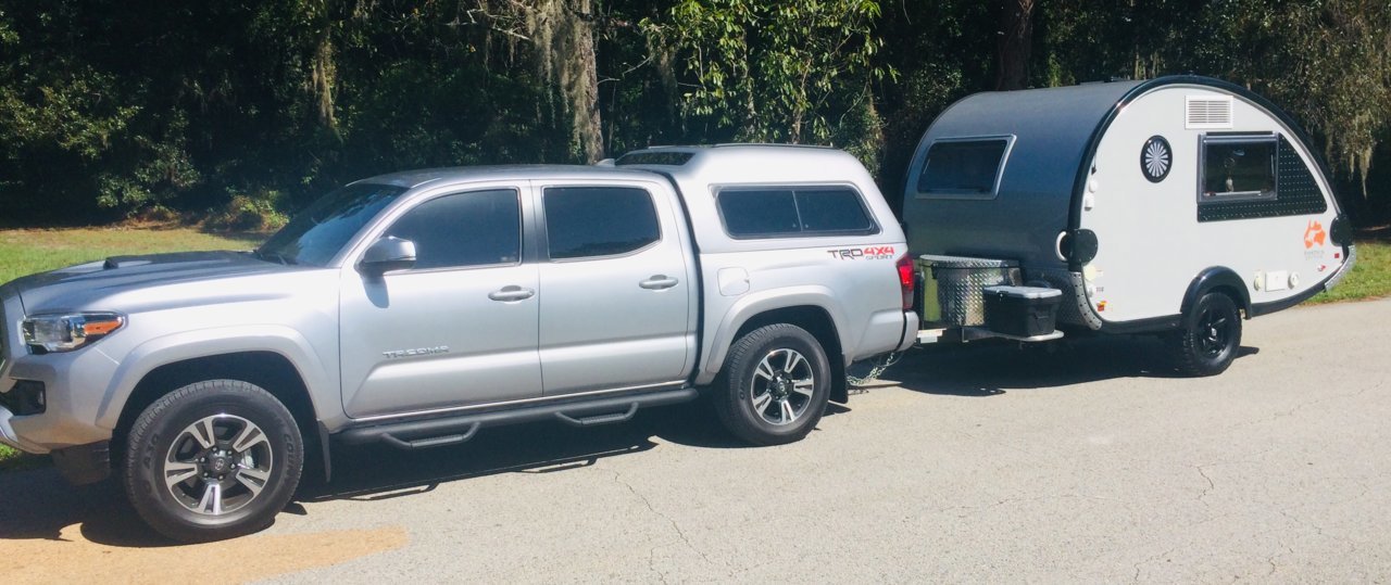

    Too big. You won’t be happy. Rent first, outdoorsy or rvshare.coms. If you’re stuck on that Airstream look at a Tundra. Or look at the 16 or 19 Airstream. I tow my T@b around the country and would never do that Airstream trailer with this truck.upload_2020-6-9_16-16-54.jpg

    That’s a cool t@b. How much did that trailer set you back?
