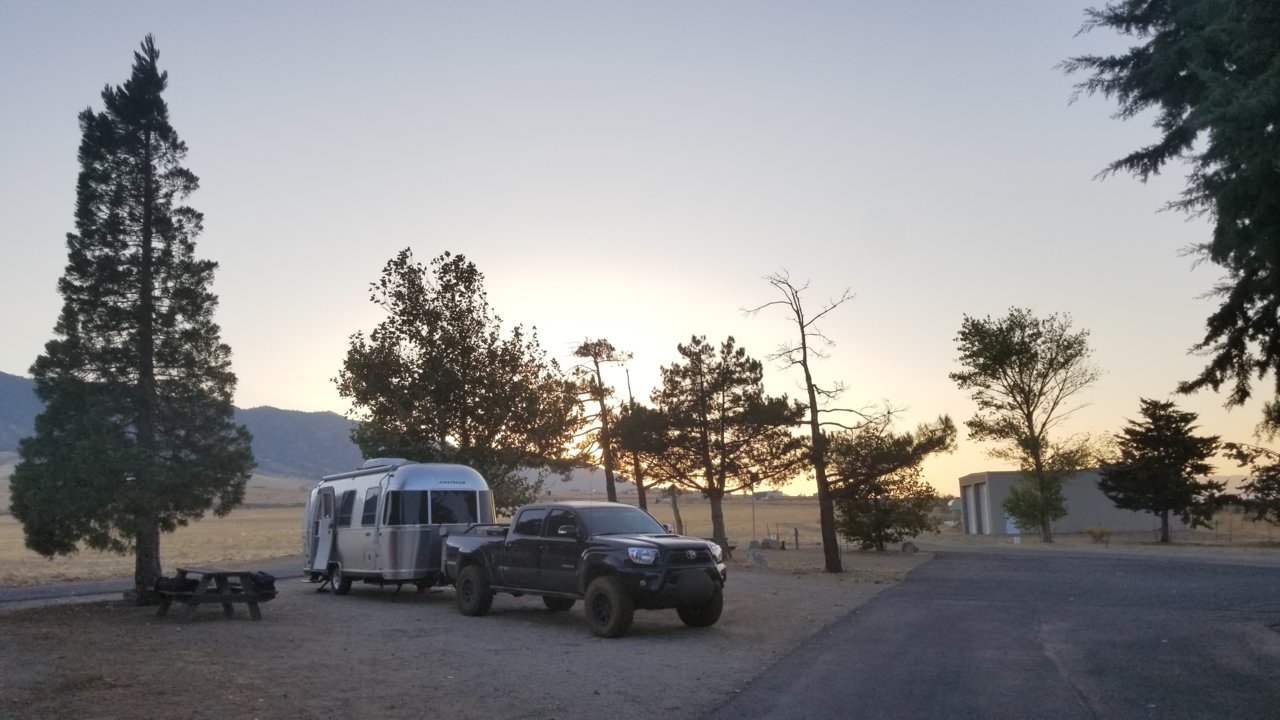

    Late reply, but thought I'd share that I've towed my Airstream Sport 22 FB from Bay Area California to National Parks like (Capitol Reef, Bryce, Canyonlands, Archies, and Zion) and Monument Valley. It works, but I highly recommend the towing package, an add a leaf (overload left in) or a leaf pack to avoid sag. I have an add a leaf and it works fine and plan to upgrade later. I have not have any over heating. Highest grade I've come across based on signs were 11% and elevations at 8300 u elevation.
    If one were to choose a Tundra over a Tacoma for towing somewhere around 4K, I'd say that's the better option overall. I just didn't get the Tundra because it wouldn't fit in my garage. Maybe in the future. However, my Tacoma does fine. I enjoy seeing other Tacos tow. Towing is not a race. Safety first.
    On a side note. The Sport 22 FB is the narrowest trailer in the Bambi line. The new Caravel line up is even heavier. I previously had the Sport 16 RB and it was a better towing experience because it was lighter. The new models out there now are slightly wider where you'll need to get towing mirrors.
