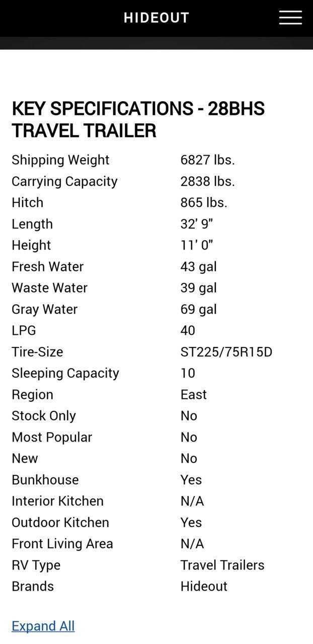

    Question... I am going to be picking up a trailer this spring and I have one selected. Issue is it maxes out the towing capacity of the Taco at dry weight....
    I cant seem to find a different trailer that meets my needs that weighs less than this and compete with the price at the same time.
    I intend to use this trailer as a dwelling and not a camping only item. It won't be moved very often, Im just divorced single and alone in a house that I dont need. Im more of a minimalist and I like the idea of the freedom camper living provides as well.
    So do you think towing this beast will kill my truck? Or will it be okay to tow dry once in a blue moon.

    :eek: Wow the tongue weight alone is 200lbs over what the truck can handle. You need a lot more truck or a lot less camper. Seems like a lot more than a minimalist needs.

    I understand where you are coming from. But if I were in your spot and really wanted that trailer, I would probably get a friend with a bigger truck to pull it where you need it to go. If you are never going to pull it places, then getting somebody else to tow it for you would be a decent option.
    If you are going to move it around often, then you need a smaller camper or a bigger truck.

    Well minimalist in the sense that I am downsizing from a 3500sq ft house on an acre and a half lot, and 2 vehicles down to one(just sold the car last night as a matter of fact:D) to a 28bhs trailer. I would like to not go much smaller than this trailer if I can help it, But I do see your point as well.
    If I were to upgrade the rear suspension by aals and heavy shocks or an airbag system would you think it would cut it?
    Im not opposed to renting a halfton to transport the trailer if I absolutely cannot avoid it.

    The dealer will probably not even let you tow it off their lot with your truck. I'd guess that once you are loaded with your possessions, propane, and water you are going to be in the neighborhood of 1,000lbs overweight.
    Your truck can probably do it if properly equipped but you're going to be a hazard for others on the road.
