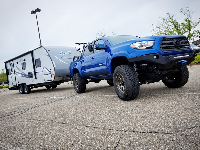

    Max tongue weight and GVWR of the truck seem to be the hard limit on tow capacity in these trucks from a safety perspective. But from a comfort perspective, length of the trailer and frontal area are the big ones IMHO.
    We just switched from an 8' wide, 5200lb loaded 25' trailer (29' tongue to tail) which was miserable to pull, to a 7.5' wide 4500 loaded 21' trailer (25' t to t) which is a dream to pull. The new camper has a smaller better shaped nose that helps keep the truck RPMs down.
    I don't like towing to be sketchy at all, so I was skeptical about the Taco tow rating as well. I would never put 6800k behind this truck, stock or not.
