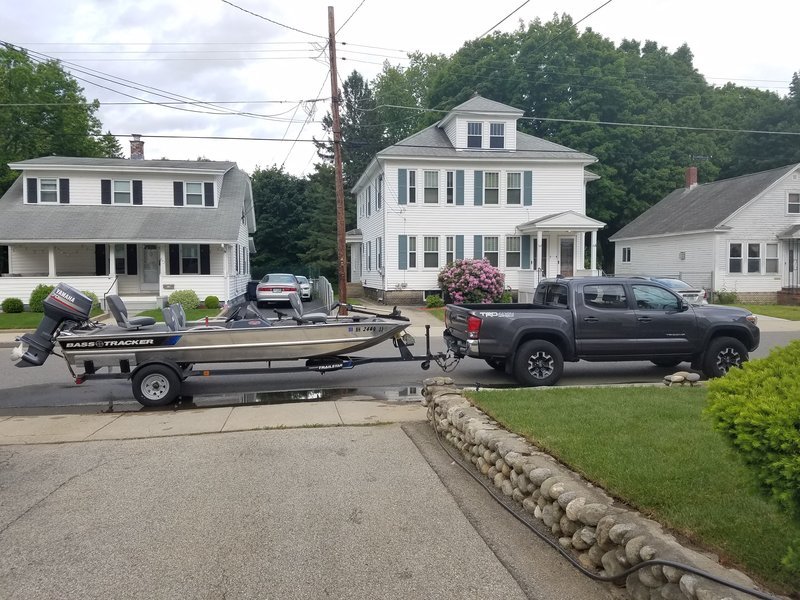

    20170603_180200.jpg 2700lbs loaded up. No issue towing. Most of the time in 4th on back roads. 5th in the flats. Comfortably pulls up hills in 3rd. And I'm in NH so i mean small mountains. Manual transmission.

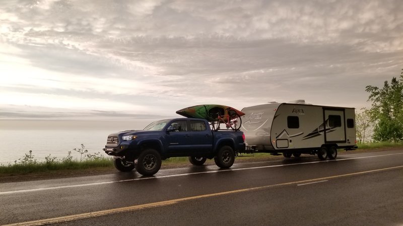

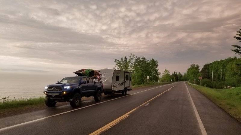

    6" lifted truck, 34" tires, 4.88 gears, ~4,600 lb loaded 21' camper, two kayaks, two bikes, me, my wife, and a dog, 1,400 miles, no problems. Pulled awesome at 65. Fuel mileage was around 9-10, but it's only about 15 with the lift and tires.
    TC temps never got above 230 and that was trying to maintain 60-65 on big grades. Pan temps right around 210. Still on the stock cooler with the thermostat pinned.
