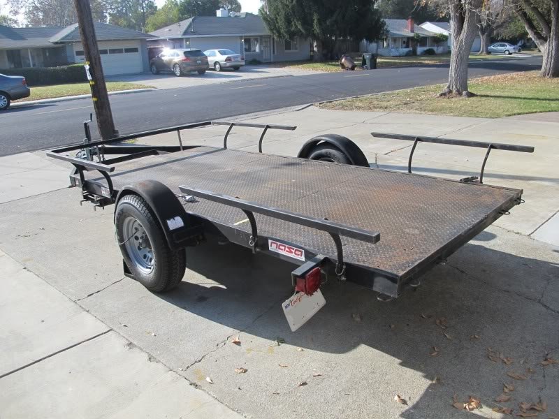

    Driving from California to Florida and I need to tow a 04 VW Golf behind me.
    Here is the specs I have, please provide any insight. I read the Tacoma Towing Bible thread. Great info.
    07 Tacoma 4x4 4cy Ac Cab Manual w/ 48k miles, 6" lift, 33" A/T tires, 4:56 gears. Class 3 tow hitch sits at 24"
    18' trailer single axle 3500#, sits at 20". Trailer has 12' 1" by 6" 5" surface with railings that stick out 9 inches. 5'9" from front of trailer surface to hitch
    Towing 04 golf 13' by 6.5' 2700 pounds.
    Truck will have two passengers 300#, 500# or less of personnel gear.
    Plan to load engine forward of axle and keep the trailer at or under 3500#. Take 99 to I-15 and I-40 across at 55mph. I've read you can tow at 70 in TX and 75 in Louisiana but I have no intention to. Any insight on this set up or a similar experience/ grades to be aware of appreciated. Car can be unloaded and driven if the weather turns to **** / etc. Also list any must stops/ sites and food.
    Thanks, Ryan

    I cant tell if that trailer has brakes or bot. If it doesn't be extra careful with your stopping distance. Also don't forget a spare for the trailer and tools to change it.

    I picked up a 10k # race car tie down set, 2 tie backs and 2 ratcheting axle tie downs. Each one is rated at 10k#. Also got some of the tow mirrors recommended on the tow thread and some wheel chocks for the car and trailer.
    Plan to drive south from Sacramento area, around the grapevine and connect to the 10. I have two spare tires for the trailer (tires on trailer are in excellent shape), one spare for the truck, a 5 gallon gas can and a good toolbox.
