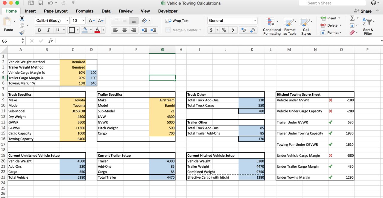

    I did a quick perusal of the towing forum and found a few links to online spreadsheets. I tried a few, and ultimately wasn't happy with the detail, format, quality, smell, whatever, and so started to make my own.
    Below is a quick draft of what I'm working on at the moment. Orange is data entry. Blue is calculated. I don't know if there's a method of posting files in a reserved area (perhaps a garage... I need to look). I'd be willing to post up a working sheet if others thought there might be value. I'm also willing to edit/add what others think might be of value.
    For this one, I haven't fleshed out the final logic yet, but it should be able to work from either 'scale weights' or itemized weights once I'm done. In the end, it should be a protected sheet (blank password) so that you can't 'mess it up easily'.
    For the itemized option, there are separate sheets and you simply add your objects and weights in columns. The front page will find and add them up for you.
    Open to comments/suggestions.

    That’s a complicated spreadsheet to work out a few really simple solutions.

    Perhaps... sometimes I find that having a spot to put data reminds you of things you would forget. For example.... A part of me laments adding 210lbs of sliders, thus eating up 20% of my cargo capacity.
    I tend to overbuild things. Spreadsheets included.
