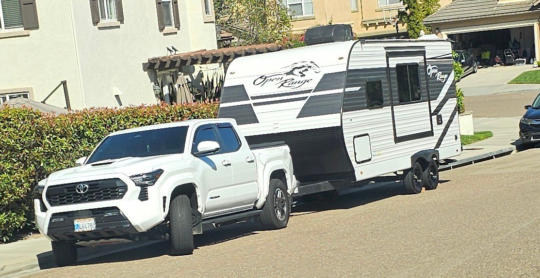

    I can't help you with that question, but how much does your camper weigh and how does it feel to tow it?

    20ft 4800lbs loaded, I live in So-cal with plenty of climbing. I have only pulled 100 miles, so far so good. No issues on big climbs, down the mountain or highway at 60. I am a novice and have taken it slow. Rear end drops an inch when hitched.
