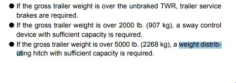

    According to my owners manual you will need trailer brakes, Sway Bar, & WDH.

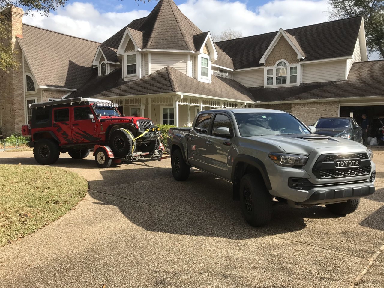

    Just came across this. Pissed me off, wouldn’t let me rent their dolly to tow a Jeep. I know why their computer said it wasn’t possible, and when I explained I’m going to pull the drive shaft on the Jeep, so it doesn’t matter, they just looked at me with a blank stair. So told them to put a front wheel drive Acura in the computer, then they were fine renting me the dolly, and away I went.
    This is the first time I’ve bothered using the Tacoma to tow, I’ve towed a lot of shit with different vehicles and trailers, have to say the 3rd gen Tacoma is absolutely crap at towing even something light like this. (And those u hall car dollys are also horrible). Friend broke down 15 miles away (bust front axle), so was quicker to go to local u hall and get dolly rather than get the 1ton diesel out and go to storage and get real trailer, then go through the hassle of getting the Jeep onto a trailer with busted axle. Plus I knew towing him with a Tacoma would piss him off...:)
    Yes the Tacoma can tow, but no I wouldn’t recommend it.
