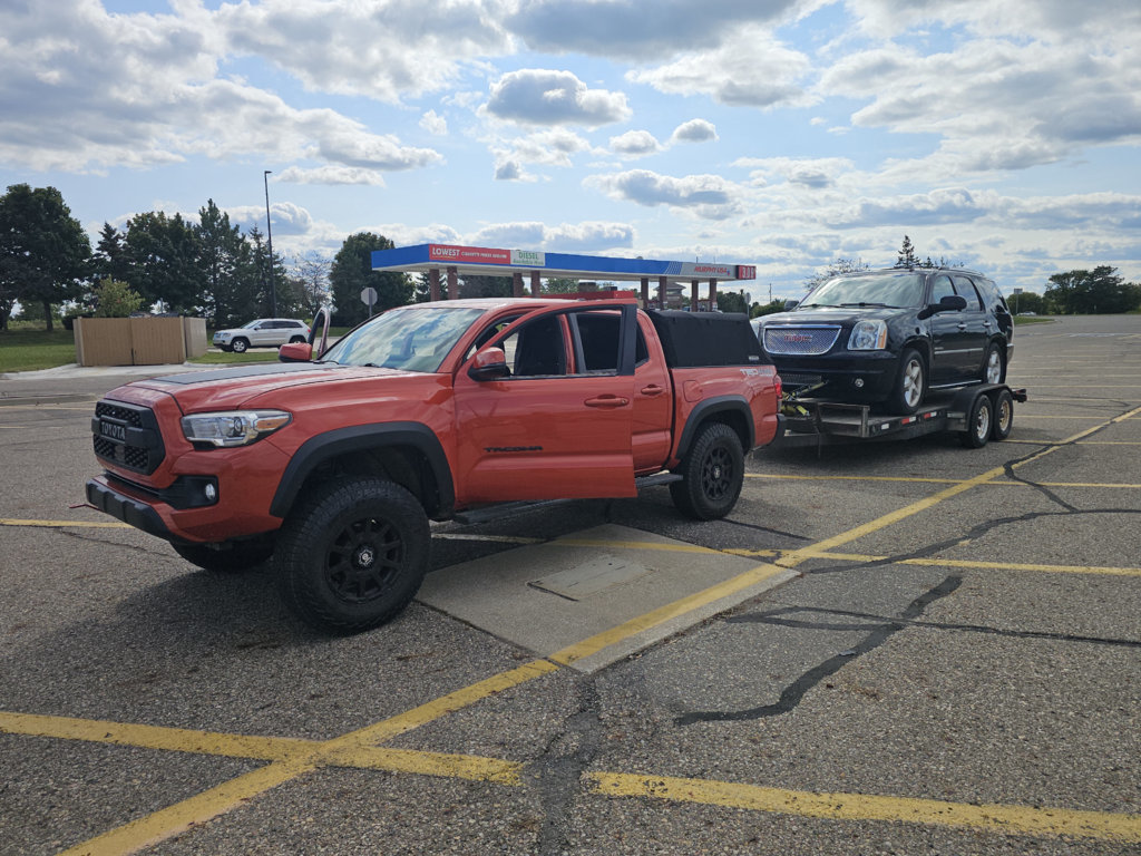

    If you are honest with U haul they may not rent you the trailer.
      • Must weigh at least 3,500 lbs. (curb weight), and must equal or exceed 80% of the combined weight of the trailer (2,210 lbs.) and the vehicle being towed (up to 5,290 lbs.).
    They use the published curb weights for calculations:
    Trailer: 2210
    BMW: 3197 to 3560
    Total: 5407 to 5770
    80% of total: 4325 to 4616
    Tacoma: 4425
    You can't use a weight distributing hitch with a U haul auto transport due to the surge brakes, that said it (the transport) is a wonderfully designed machine, easy to load and tow.
    Last month I did a 2400 mile round trip to get a car, my trailer weighs 1500 and the car weights around 3100 so 4600 pounds total. I use a weight distributing hitch & electric brakes.
    The truck is completely stock down to the Firestone LE2 tires.
    This was across Ohio, Indiana, Illinois & Missouri so flat for the most part.
    My truck is a manual so all 1200 miles of loaded driving was done in 4th gear maximum at the posted speed limit so about 3400 RPM maximum. At this RPM the engine is well into the power band and normal grades on the highway were no problem.
    Slow speed driving was a bit of a chore due to this engine having the off idle torque of a moped but ultimately workable.
    Total miles -- 2412
    Total gallons -- 155
    Fuel cost -- $549.87
    MPG no trailer -- 20.98
    MPG empty trailer -- 18.23
    MPG loaded trailer -- 11.39
    GilbertOz likes this.

    This post is a good example of someone who knows the rules, the limitations, etc. and made it work.
    I assume you have a 2.7L 4-cylinder based on your normal MPG ratings? Yeah 160 HP towing that size/weight trailer is going to feel a bit slow getting up to speed.
    The 3.5L V6 270 HP is a massive boost in power which would feel a lot snappier when accelerating or sustaining a long moderate climb.

    You're towing someone else's car? Are you prepared to buy this car from them if you or any other crazy person on the road spills it?
    Forget tow capacities. You're running some serious liability risks there, if I read that correctly and it's not your car.
    That would be a hell no from me, for any compensation.

    I wouldn't do it because you exceeded the rating
    I've pulled slightly lighter (S2000 on a U-Haul trailer) with an almost empty truck (100 lbs of tools and parts) that only has 265/70R17s and yes the truck survived, but I'd only do that occasionally

    Forget everything else, your truck will PULL 5500 lbs, but the suspension may be overloaded. Find your payload, it is printed on a sticker on the drivers door jamb. Most 4X4 DC 3rd gen Tacoma's will be 900-1100 lbs. Then calculate 13% of trailer weight to determine tongue weight. A WDH will be another 50-100 lbs. A 5500 lb trailer will eat up 750-800 lbs of your payload. Then you have to account for the weight of the driver, passengers and cargo inside the truck.
    You'll have to do the math for your truck, but you should be able to just make the limit as long as you are the only person in the truck. If there will be passengers and other cargo in the truck, you'll likely be overloaded.
    That said, there has never been a truck that wasn't overloaded at some point. If you're borderline and drive carefully you may be OK. I wouldn't advise doing something like this on a regular basis. Done once, or rarely you should be OK. But if someone needs to pull that much regularly you'll wear out the smaller truck a lot sooner whereas a bigger truck does it with ease.

    It will tow 8k LBs, handles really good up to 65mph, it felt okay up to 75mph but definitely felt it in corners, with the tongue weight as perfectly balanced as it can be for a rescue. Not that I would advise it, nor do I want to do it again without a weight distribution hitch of sorts if i was actually transporting.
    Helps to artificially increase your curb weight by 700LBs with drawers, tools, water, chef boyardee cans of ravioli, and loose change.
    Air up tires to correct tow pressure, door sill pressure is for a unloaded, non-towing, vehicle on factory tires. Can find the correct pressure needed usually on tire manufacturers website.
