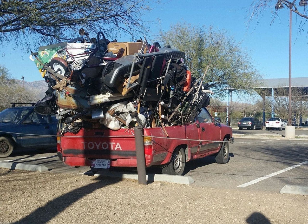

    I think this guy is way over payload.

    First thing my eye saw was the E39 in the background. :p

    Sorry what is the E39 that you speak of.

    I see did'nt notice cause I was looking at the load on that poor 1 Gen tacoma. If that little truck can handle that weight then our 3 Generation would probably handle all that weight including the truck too :rofl:
