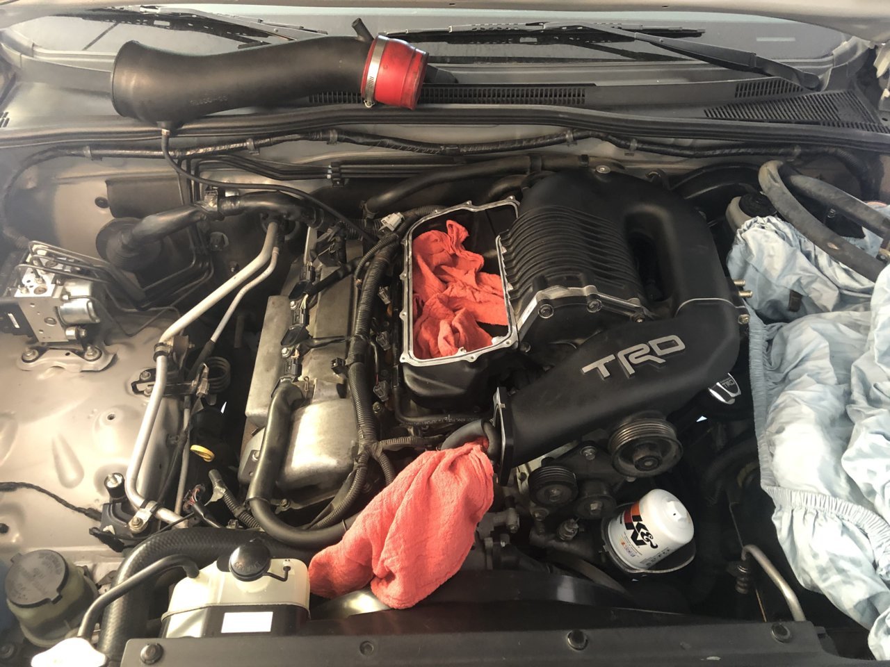

    1,948
    Tom
    2007 Tacoma 4.0
    2.5 inch lift, 285/75r16s, upgraded stereo system, Magnuson mp90 supercharger system.
    I’m also supercharged my guy so your not making more power then this 4.0 but it doesn’t change what the rest of the truck is capable of. If anything it makes it worse cause you are already pushing things harder with forced induction but load that shit up my guy. Worst thing you can do is break your own stuff. It’s a shame to abuse it though cause it really is a nice looking truck 823FF145-36AD-4A98-B42B-9B0CA69F0235.jpg
