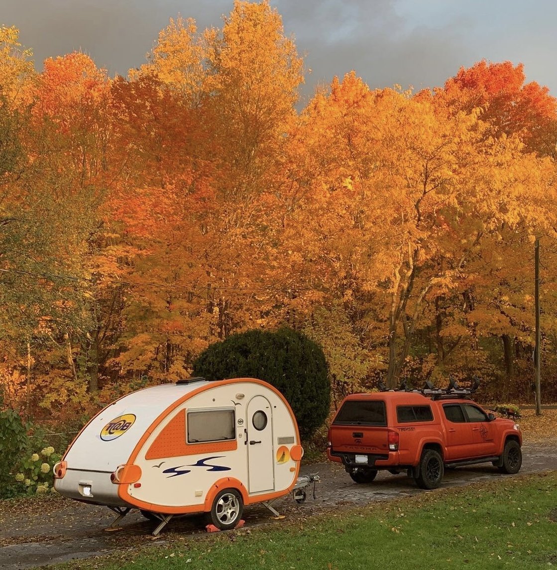

    New grill, bull bar, rims, running boards, roof rack, bug deflector, & decals. Oh and I washed it.
    It doesn’t come anymore aerodynamic than this.
    Tires are stock with no spacers. Didn’t have the cargo trunk or truck cap at the time either so I was as light as I could be.
