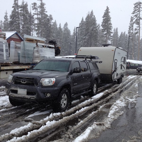

    I tow a travel trailer that's about 5,500lbs loaded. Most of my towing is in the mountains between 4k and 8k ft elevation. The transmission heats up, even in 4 but it hasn't over heated (temps never exceed 230f).
    The truck tows well but you'll want to confirm you have the towing package, get mirror extensions if your trailer is wider than the truck, and use a brake controller and weight distribution hitch. I get about 10mpg in the mountains and I'm usually going 60-65mph
    1F61F32A-1708-4917-82F7-DA3F199C26A6_zps_1b4389e156e3478080a1f53fb30667c67dde831b.jpg
