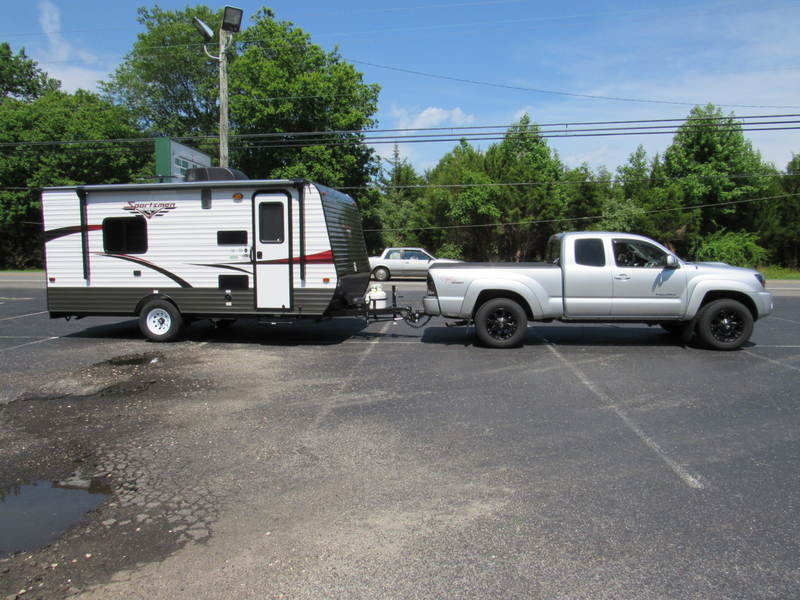

    Here is the small toy hauler we tow with my 05 tacoma pre-runner with factory tow pkg. All loaded the camper is just under 4,000 lbs. My truck does fine,But I would never do mountains or long hauls with my rig. All our trips are about 1.5 hours away so all is good. Youl want to also get a sway control set up and the prodigy brake controller. We will be getting a tundra with the 4.6 V8 in September...But were also keeping the Taco!
    2017 KZ Sportsman Classic 19FKTH (180TH)
    UVW (Unloaded Vehicle Weight)* 2,530
    Dry Hitch Weight* 400
    Dry Axle Weight* 2,130
    NCC (Net Carrying Capacity) 1,470
    GVWR 4,000
    Interior Height 75"
    Exterior Height (without A/C) 104"
    Exterior Width 90"
    Exterior Length 19' 4"
    Refrigerator (Cubic Feet) 3
    Water Heater Cap. (Gal. G/E w/DSI)Optional 6
    Fresh Water Cap. (Gal.) 38
    Waste Water Cap. (Gal.) 5
    Gray Water Cap. (Gal.) 26
    LP Gas Cap. (Lbs.) Optional 20
    Furnace BTUs (1,000s) Optional 16
    Tire Size 15"
    Awning Optional 12'
    *This weight reflects the rolling average unit weight for each model. Your trailer weight will vary according to optional equipment.

    What brand is that TH?

    KZ Sportsman classic They call the model KZ 180TH now....When we bought it last year it was called the 19FKTH
