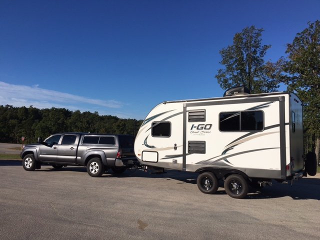

    Welcome aboard:hattip:Here's about 4200lbs ready to camp:thumbsup:. The truck does pull it good but I keep it at 60 mph. Leave it in 4th gear so the tranny does not gear hunt and generate a lot of heat.
