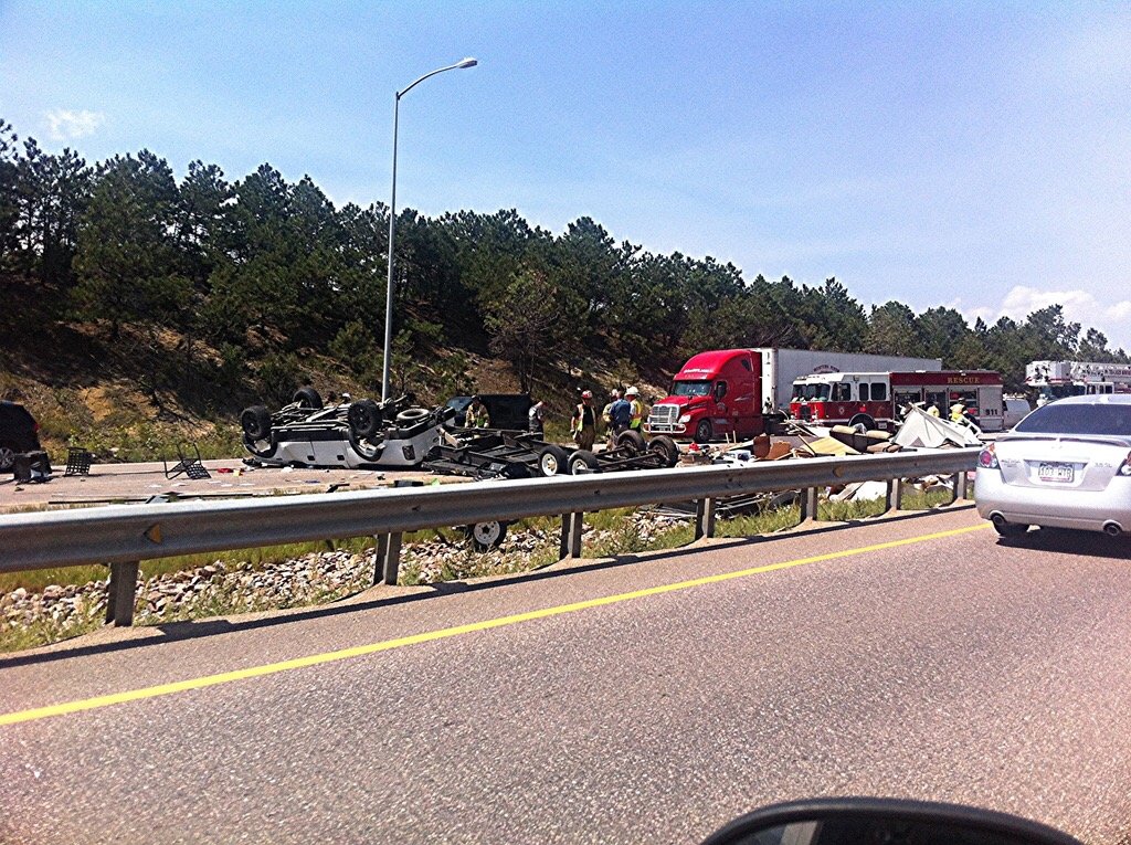

    ColoradoTJ Retired cat herder Moderator
    Sep 3, 2018
    #265097
    10,198
    Colorado
    3500 Duramax, Roush Mustang, Jeep Crawler
    I’ll just leave this here. This is 10 miles from my house, Monument Hill on I25 northbound.
    Family didn’t do well in this oops.
    As I passed, looked to be ~26’ and an F150. Read about it that evening.
    I don’t mean to be so passionate about towing, and the Tacoma is a great all around truck. It has its limits, like any vehicle. I’ve towed in commerce and privately for many years and seen some crazy accidents. To be honest, it’s usually the cocky diesel owner pulling doubles doing 84.5 mph.
    One other thing I like to ask people when this comes out their mouth “the xxx tows great!” My reply is “what are you comparing it to?”
