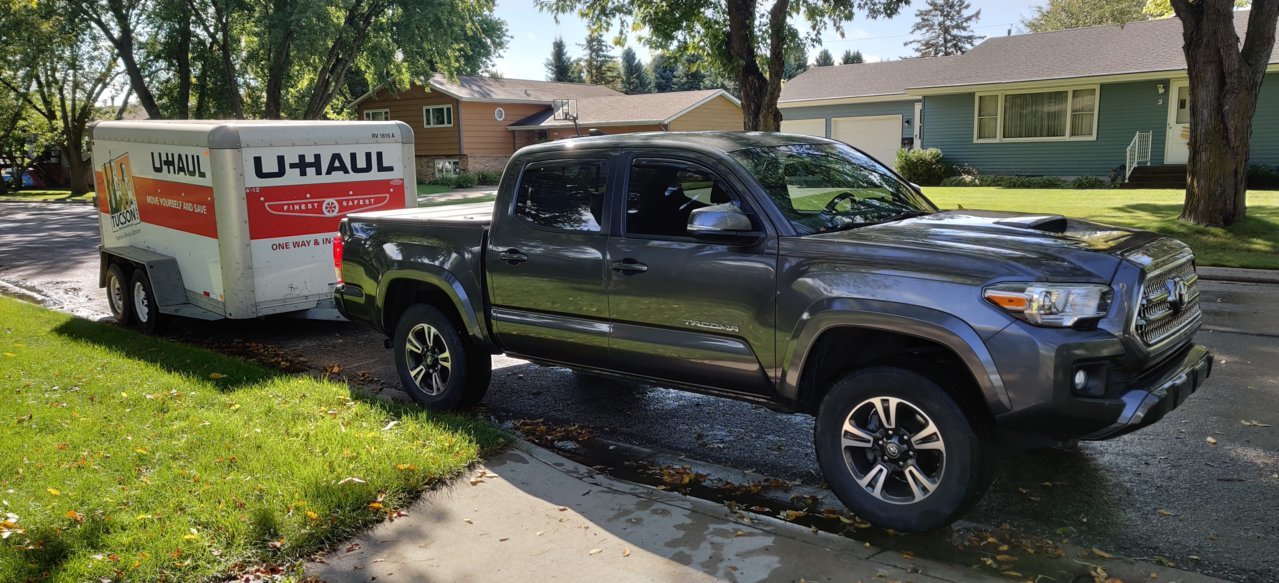

    2000lb uhaul 6x12 trailer loaded with 3000lbs of tile and a motorcycle, another 1000lb of payload in the bed and 3 passengers in the cab. Drove from MN to CO 65mph no issues.
