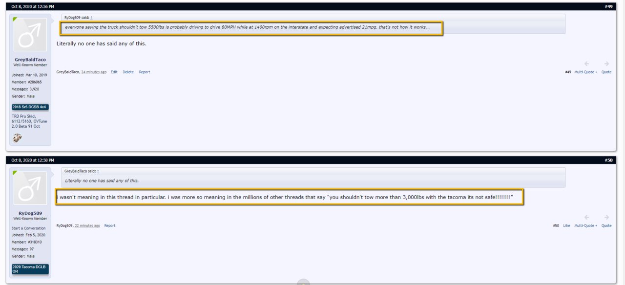

    i can't assume stuff about your weight and MPG like you can about me dropping one mention of MPG in a post? i mean either way it doesn't really matter i think he has all the info he needs. and im off work today, my laptop is at 81% so i have at least half the day to argue.

    I didn't make an assumption, what you wrote is right there in black and white......

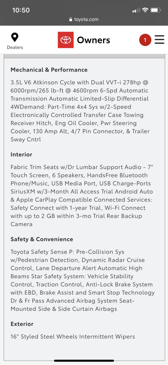

    I hate that they advertise "sway control." Sway control is if the truck's yaw sensor detects back and forth oscillation it will start pumping individual brakes (truck brakes, not trailer). What they don't tell you is that if the trailer is swinging wildly enough for the truck's computer brain to notice it, it's way, way too late.
    Good call on towing it with the Tundra. The taco can do small campers just fine. It really shines with campers that are under 4,000 pounds fully wet, even better if you can find one shorter than 18 feet hitch-to-bumper. It doesn't do so hot if you want to pull a 2 bedroom penthouse suite, though. :thumbsup:

    i want to see where i typed out MPG and safety within a few sentences of each other.

    It was definitely in the "way too late" category when it kicked in on the F150 too. I'm sure it was helpful, but by that time my sis knew it was pretty crazy and started to slow down. With an actual sway hitch, it would never have gotten to that level. So yeah, sway control on Taco is nothing like an anti-sway system on a hitch.
    EDIT: Not saying it's bad! I'm sure it's a super big help in bad situations. Just two different things.

    did i mention the MPG being a safety concern like you said? i really can't tell what your trying to get at.
