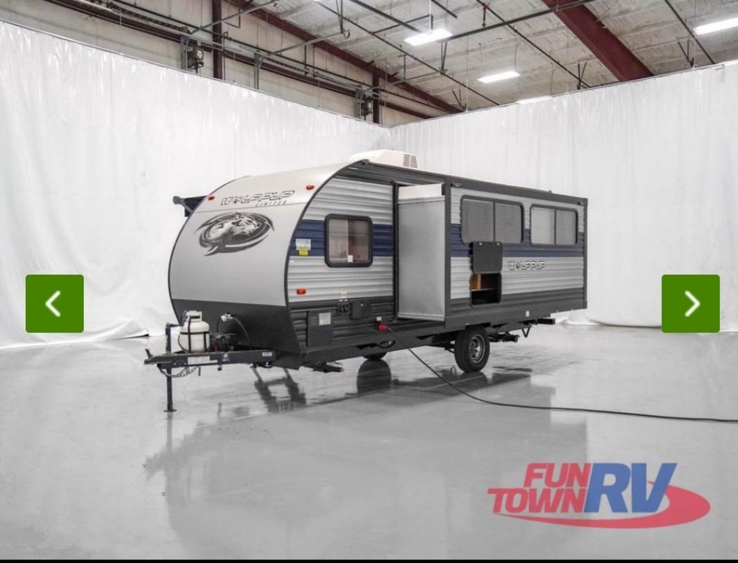

    Arcteryx 79
    Arcteryx 79 Well-Known Member
    May 16, 2020
    #328274
    123
    RJ
    Waukesha WI
    2020 Black TRD Sport DCLB
    I am looking at this and will pull the trigger during RV show time where the deals are better.
    3800 dry weight
    21 feet total length
    Won't travel with water in tanks.
    Brake controller and WD hitch will be a must at this weight.
    Towing won't be too bad. Tons of experience towing from working utility construction.
    pinochle, synaps3 and Boghog1 like this.

    Nice. Tacomas can handle a lot. Most people just think pickup truck can tow. And it can. But those big travel trailers are not like towing a landscape trailer

    definitely... it seems like it would be actually towing a house...

    Here's the thing...with the towing package you have extra fluid coolers...this adds 3000 pounds to your towing capacity...meaning the truck can structurally "handle" 6500 no matter what but you'll burn through tranny fluid and oil much faster if you don't have the coolers. You can add these coolers if yours doesn't have them...if it does you can find numerous posts on this forum as to what they look like to see if you have them or a vin search will tell you. I've also heard if you have the two trailer connectors on your bumper you probably have the towing package. But...NEVER TOW NEAR MAX! Sure it CAN handle it...but it's a strain...not smart.
    That said, I have the towing package and I towed a 4000 pound car on a car dolly (front wheels only) with moderate ease, I will occasionally...rarely...tow a 4000 pound car on a trailer and will moderately be able to do so, and my mpg's will go to the shitter and I'll drive slower but that is such a rare nonoccurence for me i couldn't justify a bigger truck.
    I bought this truck because I RARELY tow a car, I typically haul plywood sheets (4X6 1/2") and some 2x4's so I don't need a larger towing capacity. At most I'll use a small trailer (I have the short bed so a trailer that can handle the plywood with more ease). Sure I COULD tow a 5-6000 pound camper...but if I were to do so regularly, or haul cars on a trailer regularly, I would NOT have bought a tacoma.
    I towed a 3000 pound car on a trailer with an f150 and the same exact car and trailer with a 5.7 tundra...the f150 couldn't take off or stop, total POS...it was horrible...I felt safer towing with my tacoma! Now, with the tundra I literally looked in my rear view twice during my 40 min drive because I thought I lost the trailer the damn thing accelerated and stopped so well. My tacoma...heavier car and only front end dolly...it took off and stopped OK but I never doubted I was hauling something but it didn't worry me like that damned f150 did. IF I wanted to tow a trailer, even a 5-6000 pound one (those aren't really that big/comfy btw) I would NOT have a tacoma. CAN you...yes...should you...meh...would I...hell no. i wouldn't do that with ANY v6 though...or even an f150 XD
    You HAVE a camper...and it weighs nearly the max of the towing packaged tacomas limit...CAN you? yes (if you can confirm you have the towing package)...should you...i say no...not regularly. If you're going to haul that thing more than once every 5 years...and up hills...get a dodge ram or at LEAST the 5.7 Tundra

    I much rather pull the ops tandem axel 5200lb trailer over that single axel.

    That the Wolf Pup 18TO? My friend has an 18TO and absolutely loves it. His didn't come with a battery for some reason - make sure your dealer includes that when you buy it. His also has a 2-way 12v / 120v fridge instead of a propane / 120v fridge. If you can get the full size fridge with propane instead of 12v, you'll be able to camp off grid a lot easier since the fridge won't stay on long with 12v.
    My Wolf Pup 16BHS is 20' total length stock and about the same weight with all the mods and lift I've done. I don't use a WDH, but I have aftermarket leafs and sumosprings and it's been great. Only thing I'd recommend is replacing the garbage tires as soon as you can. Mine came with some Castle Rock tires and were showing serious wear after about 2k miles. Since it's a single axle, you don't have to run a trailer tire since there's less lateral load, so you can upgrade to a passenger or truck tire that'll last a lot longer.

    Yep. Its the 18TO. I like the full slide for more interior room. Tires will probably be replaced immediately.

    Don't use passenger car tires on the trailer. The construction is different on trailer tires.
    I was in an unfortunate position with the 2nd flat tire on a single axle tire. Both flats happened on a trip within 200 miles of each other. Long story, but the result was I could only find a passenger tire. The camper towed like crap. The camper was a 10' Coleman folding camper, weight about 2700 lbs. It swayed at any speed above 40 mph, even then my butt was harvesting seat foam at times. I was on I-10 heading to San Antonio. When I finally reached my destination, the replacement tire was so hot that it was smoking. Put the camper on jack stands, pulled all the tires. Next day, replaced all 3 with heavy duty rated trailer tires.
    Learned my lesson and was lucky to avoid disaster.
