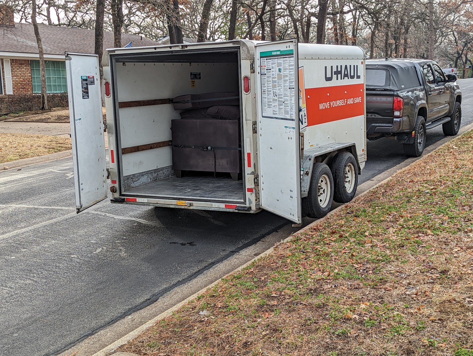

    Moving from East Coast to Wyoming. Looking for any additional information people might have for things. Pulling uhaul's biggest enclosed trailer. It has automatic hydraulic brakes but I'm looking at adding a tow controller.
    Not looking for the standard advice like "check tire pressures" but if anyone thinks a tow controller would make a world of difference or something like that pretty me know.

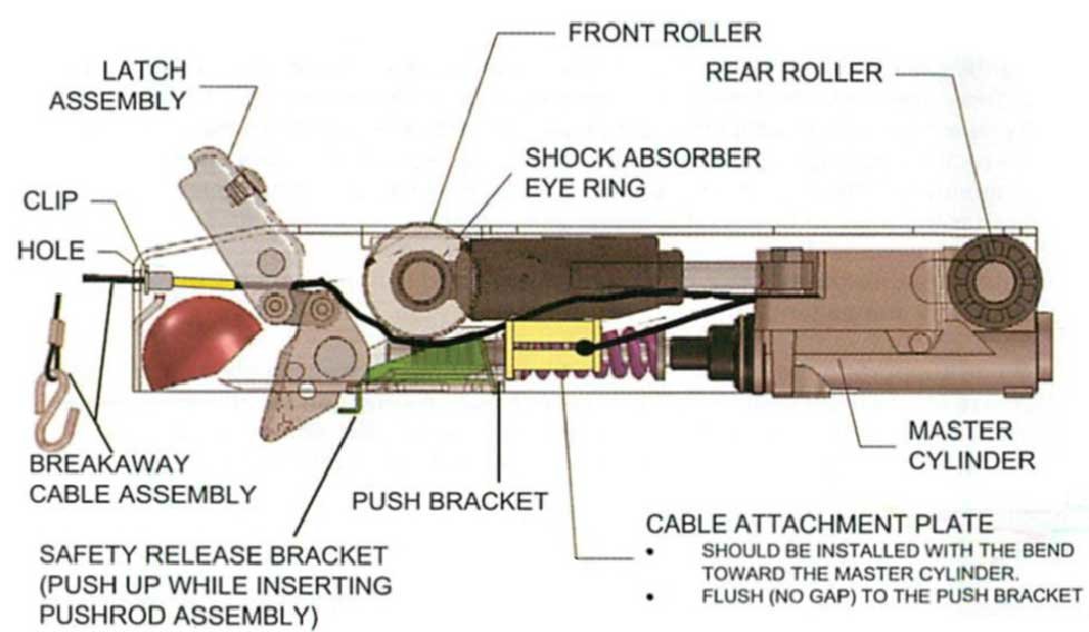

    A Brake Controller is only for Electric Brakes? How do Hydraulic Brakes get activated on the trailer?

    brakes on a U-Haul trailer called surge brakes. Long story short there was a coupling in the towbar. It has a mechanism that engages a master cylinder that hydraulically applies the brakes on the trailer.

    When the truck brakes are applied the trailer begins to "push" the truck. The push motion is proportionally applied (in theory :rolleyes: ) to the master cylinder on the trailer actuating the trailer brakes, the harder the truck is stopping the harder the trailer brakes are applied.
    The advantage being that the system is self contained on the trailer, any weight capable vehicle can pull it which is why rental companies use them.
    Some disadvantages are that they require more maintenance and adjustment than electric brakes, respond in a less linear relationship to the truck and don't generally work in reverse.
