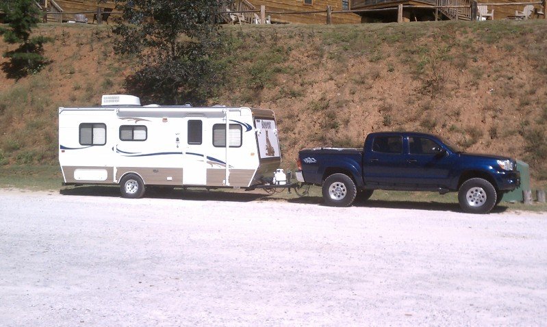

    I call bullcrap! I tow a small camper (~3500 lbs), and the dakars barely sink with the 300+ lb tongue weight - and it tows great.
