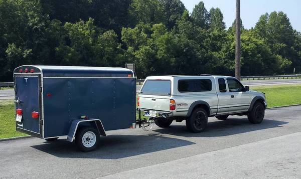

    Here's my truck/trailer, in (Dallas Cowboys Blue/Silver, as my wife/kids say)
