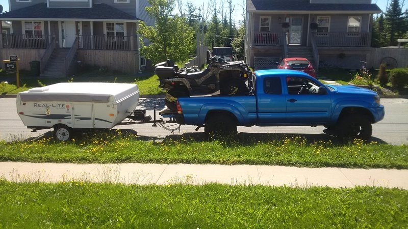

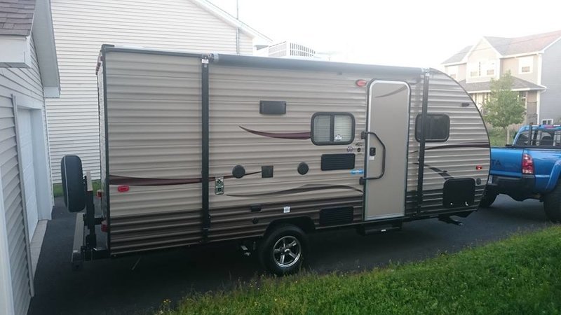

    So heres the problem I have. We recently bought a new camper and its bigger. I also have my ATV I love. I want to take both camping on weekends sometimes like I did a few times last year. We camp 10-20 times a year but only want to take both 2 or 3 times a year.
    My bike weighs around 800lbs, and the camper about 3200 loaded with our stuff. My old camper was about 1800lbs loaded. I have a homemade bed extender for the ATV that weights around 100lbs also. I installed Ride Rite air bags and have the AAL and full 3" suspension lift with the E rated 255/80/17s. AFE pro dry, doug thorley header, and all synthetic oils.
    Im really thinking the truck cannot handle the weight, and I dont want to try it. The camper along was ok, very easy on the roads but tough on the highway with the wind. Had to work 3rd gear a bit more then I wanted on the drive home.
    Im wondering what my options are here and whats best:
    -Look for a used V6 Tacoma and buy it and swap my parts and sell the 4 cylinder
    -try it and see how it works first
    -URD supercharger kit
    -downsize tires and look into regearing
    Frustrated right now and dont see anything I want to buy. Reading over the supercharger kits and I dont overly like the warnings it gives you on over heating/using 93 octane (we only have 91)/etc. But I do not like to do things unsafe on the road, so I want to make sure its the right decision. Realistically this truck can tow 6500lbs like the V6, just without the power. But do I want to put this truck through hell a couple times a year towing this? I was able to shave 200-300 lbs off my old setup and camping gear, but that still leaves about 1200 more lbs.
    First picture is my old camper setup before the air bags though so it sags, then second picture is the new camper.

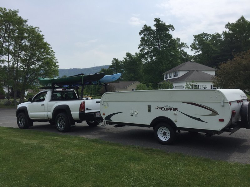

    Ive found that my 2.7 has absolutely no issue pulling a 2000 plus lb camper. With that said, I'm also running stock sized tires with no lift. image.jpg
    George1441 likes this.
