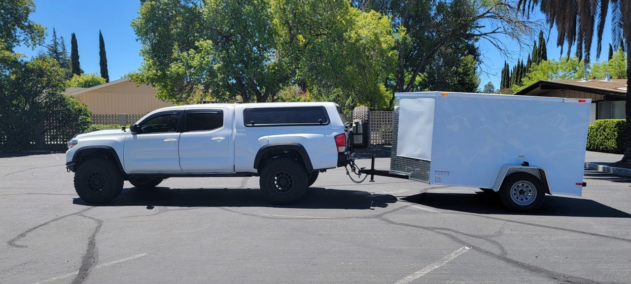

    I'm driving from CA to NH 3200 miles on the 23rd this month. Bought a small 5x8 v nose for the trip.20210613_120437.jpg

    My only concern is how heavy my truck is and turning the 35s. Only place that is crazy hills tho is the east side of Salt Lake city. After that is smooth sailing

    Are you geared? I'm on 5.29s

    I'm currently towing a small v nose packed to the top. Around 2500lbs total. With my ovtune and 5.29s I can tow in 6th comfortably. Hills I'll slap it down to 4th but at 75mph I'm at 2350 rpm in 6th
