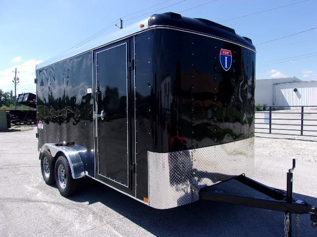

    Welp. Game on. Just purchased a 7x14 Interstate enclosed trailer. It'll be here Tuesday. Replacing my tow plug (since I smashed it off roading) and installing brake controller this weekend. Got extended tow mirrors. A friend is hooking me up with a weight distribution hitch and anti sway setup. Should be good to go when the move happens in 2 months!

    looks good. i towed a very similar trailer loaded with all of my and my wife's college stuff from Idaho to Alaska. kept it in 4 and went slow. it was heavy but we made it without major incident. this was all on stock 2010 sport 90k miles. didnt pass a fuel station and was glad to have 10 gal spare as we did use that once in between villages. doesnt sound like you will have that issue going through the states tho.
