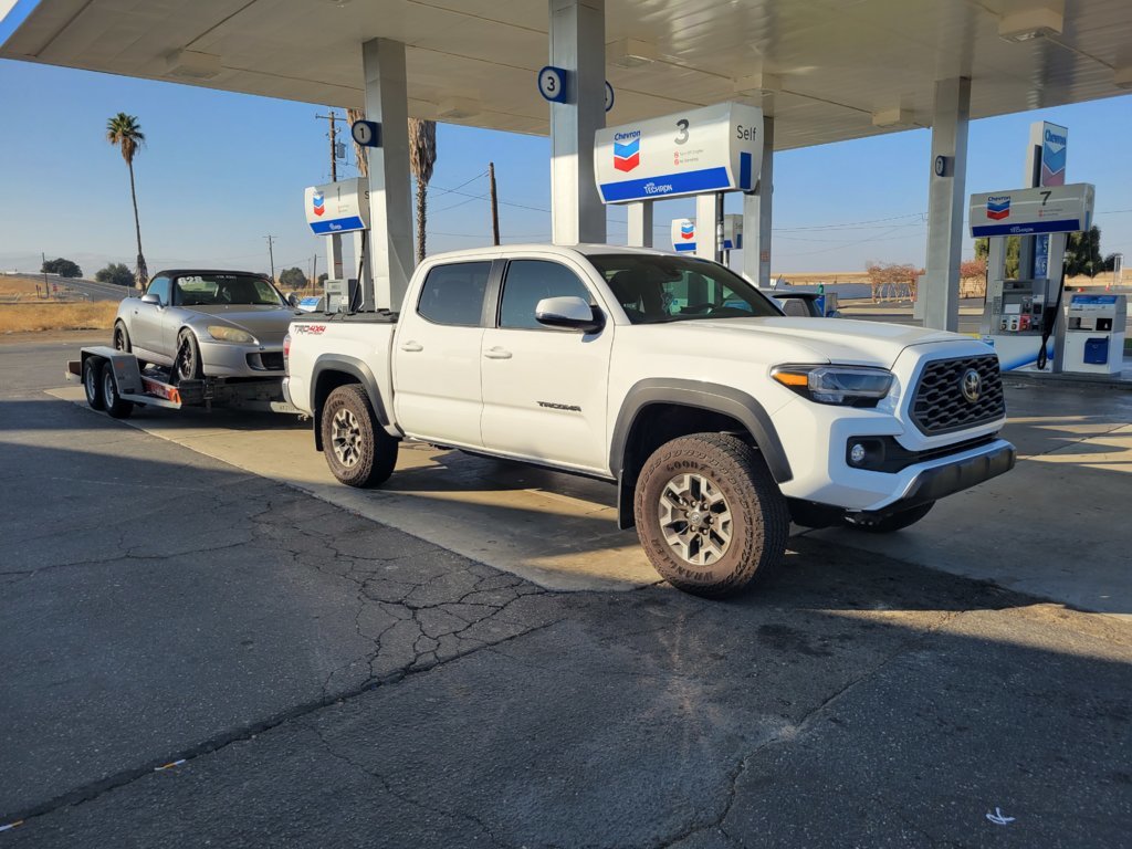

    Old pic of my TRD Off-Road 6MT towing a Honda S2000 (around 2800 lbs) on a U-Haul trailer (2210 lbs). Pulled to the track and back (500 miles total) that also includes some inclines and declines.
    You’ll be fine. You don’t need a trailer brake controller for this trailer, as the U-Haul trailer has its own surge brakes.
    Whenever you want to accelerate harder, you’ll have to rev the truck out because the truck makes its power on the higher end.
    I got 13-14 MPG that trip. Expect around that amount or lower depending on conditions
    Reversing the trailer may be annoying. You’ll have to slip the clutch a lot because the reverse gear is tall.

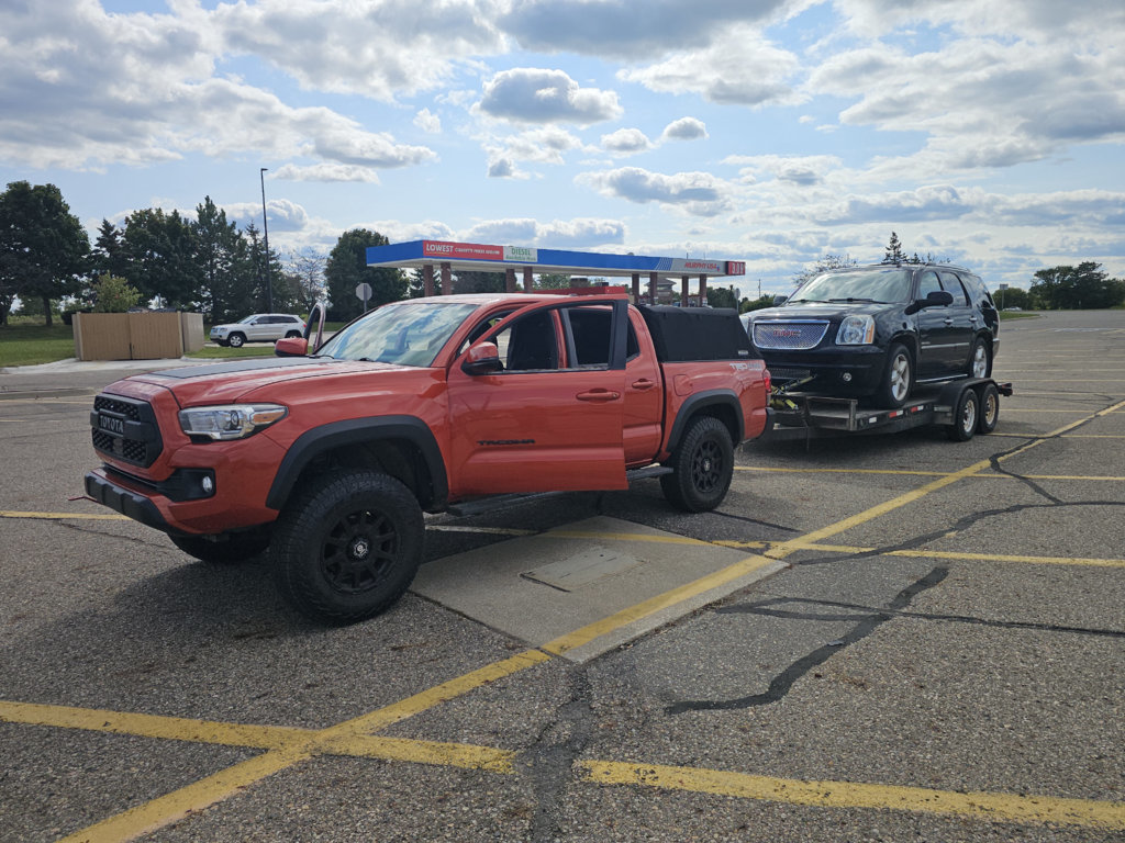

    Why wouldn't you use a 6.0/6.2 V8 as the tow vehicle instead of the Tacoma? Unless it was inop for some reason.

    I've seen a Tacoma towing a Tahoe locally and wondered the same thing, it made no sense to me (even if it wasn't over the weight limit).

    GMC's Displacment on Demand failed on both of them, the 6.2 sounded like it like the active lifter froze and was machining the end of the cam lobe off and the 6.0 active lifter did explode, and some how did it in a way that it dropped the entire valve into the combustion chamber. Thankfully the 6.0 was just a friends a truck, so not my problem.
    Even then, why not use the Tacoma?
