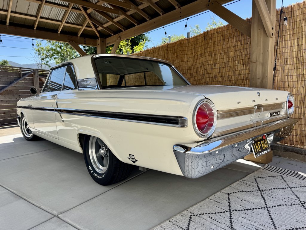

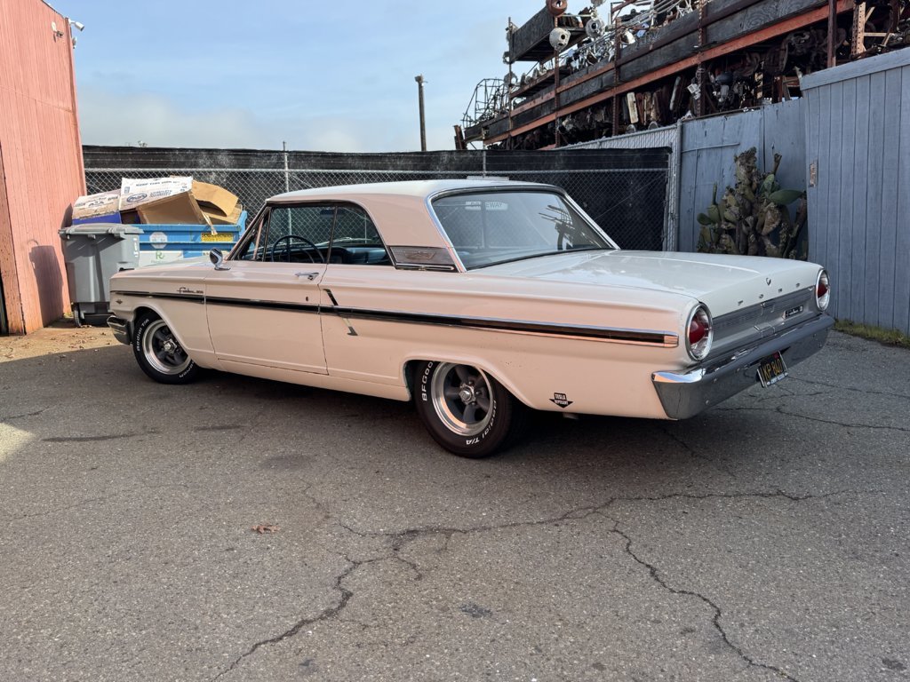

    I would need to see more pics of the car before I can give my expert advice.
    23MGM and Gmak621[OP] like this.

    realizing I need more/better photos of it
