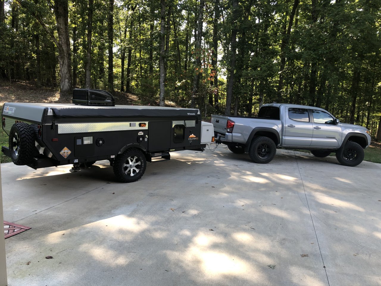

    My last camper was 5600 lbs dry and I pulled it with my ‘13 Offroad on 33’s but the truck had 4.30 gears. I used a Reese “strait line” kit with dual cam sway control and the weight distribution hitch. Still sagged the truck down on Dakar leaves about 2”. I was using a Prodigy P3 brake controller. Could it do it? Yes. Did I wish I’d have gotten a lighter camper every single time I pulled it? Yep. I wound up trading it for a E3 Evolution offroad popup that weighs about half as much and I’m a lot happier with this setup. From now on I don’t think I’ll ever go over 1/2 the tow rating with dry weight. Also, I put air bags on my new truck and love the adjustability for sag.
