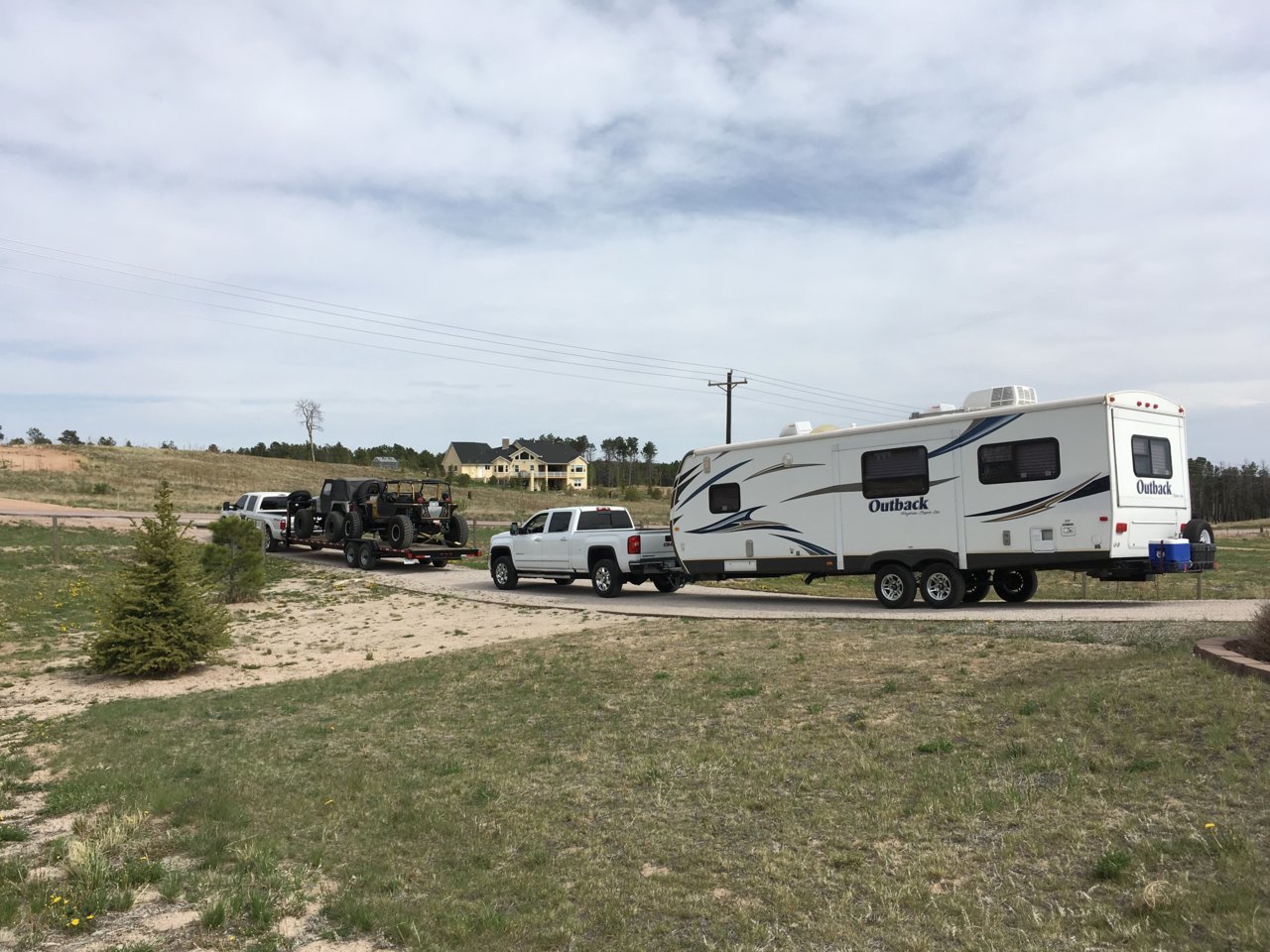

    One more thing that I forgot.
    Load capacity. Once you start a business, get all your licenses (DOT), and business logo on the truck, you now fall under DOT regulations. Now you need to pull into all DOT safety check points, get weighed, etc.
    So I have a buddy with a 2011 F250 CC Lariat 6.7L short bed and his load capacity is 1984 lbs. that really isn’t a whole lot for a 3/4 ton diesel. You can see how quickly one could be overweight rather quickly. When he is pulling the toys and I’m pulling the mobile living arrangements, he is definitely over. With both crawlers and the 28’ gooseneck, his pin weight is ~2700-2800 lbs.
    My work truck is the same exact truck except it has a 6.2L gas motor and three years newer. The load capacity on this truck is 3108 lbs. So by going with the gas option, you get way more capacity. Less trouble with being overloaded, and less maintenance.
