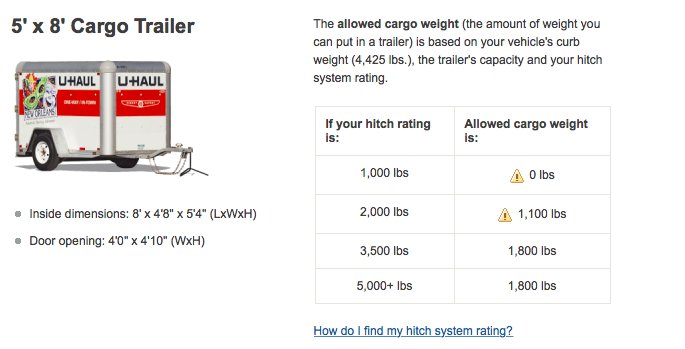

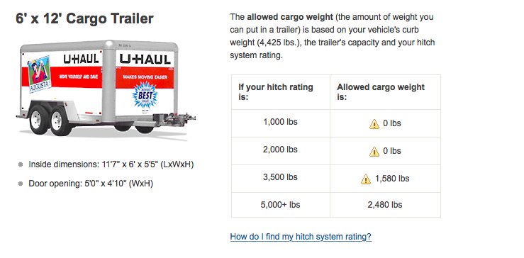

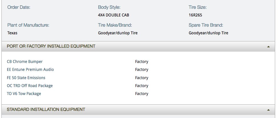

    I'm setting up a move from the panhandle of Florida to Omaha, NE (yes in the middle of winter). I haven't towed anything with my TRD OR DC 4G(5.5 ft bed) yet. I'm looking at my options at uhaul. We don't plan on loading it with anything heavy (no appliances just very minimal furniture, i.e. writing desk, kitchen table, tv stand, decompressed memory foam mattress, and the rest would be regular 1 bedroom apartment belongings). I will put the lighter stuff like clothing and kitchen stuff in the bed of the truck. In your experience, what is the best option available between the 5x8 or 6x12. The 6x12 seems to be the best as it holds more weight but can the Taco comfortably tow? I remember the service manager at toyota telling me I had a class III hitch, I've yet to confirm this.
    Question is, can I safely tow the 6x12 uhaul vs the 5x8. I'd like to have just a little more room if necessary. The manual says GCWR is 11280 lbs and the TWR is 6400 lbs IF I have the tow package. I'm only 90% sure I have the tow package (there is a hitch and wired plug for lights). I'm going to put my VIN into toyota's site to double check.
    Anyone with any experience, tips, etc I would really appreciate!
    Thanks!

    That double axle trailer will handle well with your truck. Since it appears that you may have a tow package, it will be fine with either trailer, and the truck can handle them especially since you won’t be towing in summer heat if you did not get the full tow package (extra tranny and oil cooler, etc.).
    Your biggest concern will be how to mount the side mirrors, good luck with that! I ended up going with a wireless rear view camera at the rear of my trailer because I have never found a good mirror set that stays on the OEM plastic mirrors securely enough.

    most TRDs come with the tow package standard. I have towed my boat (~2000#s) over 300 miles with 0 issues and it did fine even up some pretty good grades and stopped pretty quick. I wouldnt hesitate to tow more. Obviously try and go with the smallest trailer that will fit your stuff and remember S4 to keep it out of overdrive and use ECT per the manual. Dont expect great mileage.

    Okay I do have the tow package installed

    Even the 6x12 is just a little trailer, you'll be fine. I'm guessing from the post you've never towed anything before. This forum in general vastly overthinks towing, so don't feel overwhelmed. S4 or ECT will hold lower gears longer, but you don't need to mess with those to tow unless you really want to. Longer mirrors will help, but I've never used them.
    I've towed a lot for work and for fun. Just go a bit slower, the speed limit instead of the 80mph everyone usually goes. Leave extra room for braking. Expect much longer to accelerate. The bottom line is, if you don't hurry, you won't have any trouble.

    I actually rented the 6x12 this past weekend and towed about 200 miles round trip. We had a few hundred pounds of stuff in it and then towed it empty on the return trip. The taco was fine. I usually average around 20-22 on my commute and averaged about 17-18 with the trailer. It handled accelerated and braked fine.
    I previously had a 2006 F350 Crew cab and 8 foot bed with the 6.0 diesel. I towed muhc larger and heavier things with that. That thing could two your house down the street. The taco didn't tow as effortlessly, but had no issues and never felt like it was struggling.
    I kept speeds around 60 max since the trailer says not to go above 55.
    I have a 2017 double cab short bed sport with tow package. The 6x12 uses the 4 pin connector.
    Zero issues.
