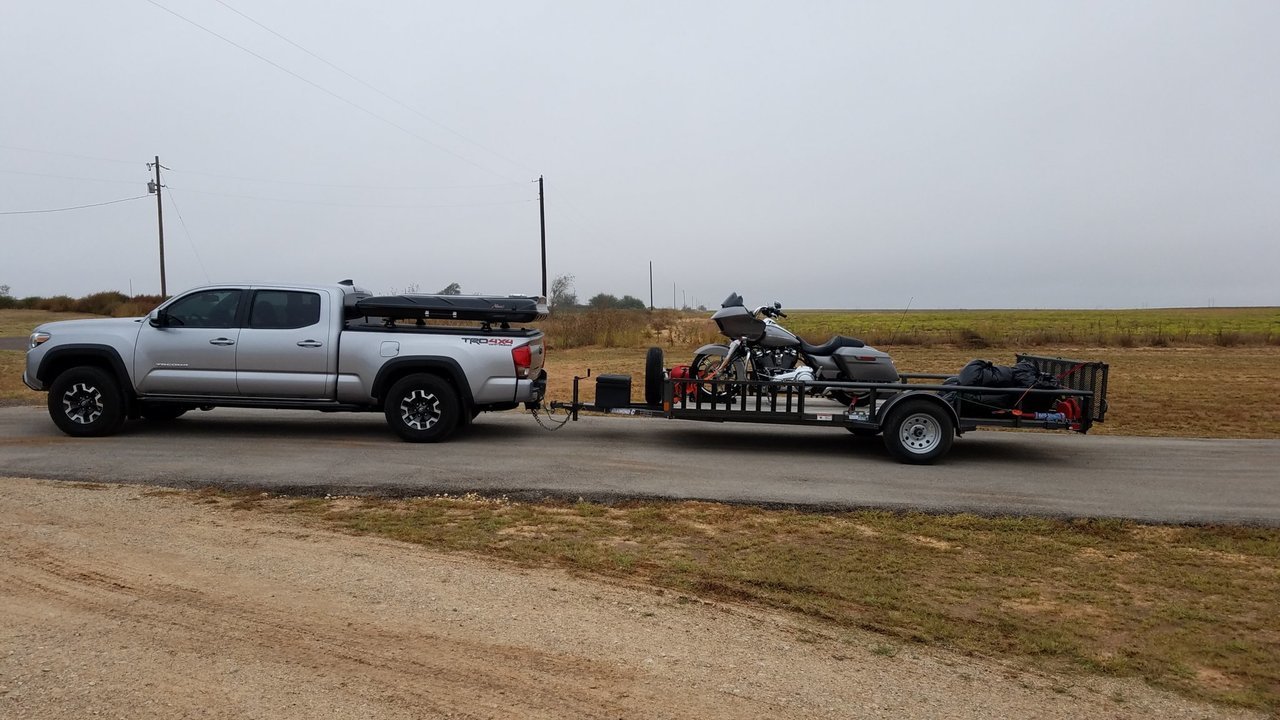

    Thanks it is the undercover ridgelander. Bars come with it. The bars slide into grooves on the top of the cover. Great cover I am very happy with it.

    I had probably 500 lbs or more in the bed as well. Only thing on the trailer was the bike.....

    because all of your trailer weight is at the tongue

    that bike center mass should have been strapped slightly ahead of the trailer wheels. even in that quoted pic, I can see the rear end squatting due to too much weight on the tongue.

    a fully loaded 6x12 uhaul trailer that was filled completely with furniture with no spare room and correctly loaded, my 4runner barely squatted at all, maybe 1/8 inch at most. I got better mpg starting in Atlanta and going thru the mountains than I did in SD and ND due to the winds.
    and the 4runner only is rated at 4700 lbs towing.

    also looks like your trailer ball needs to be lower
