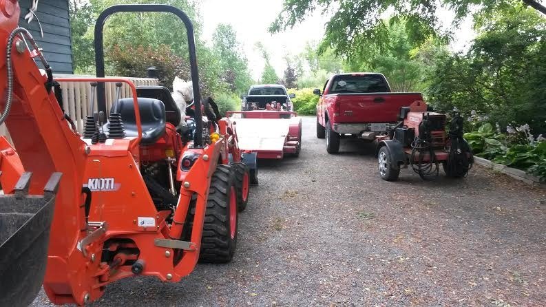

    You can do it if you set up your suspension properly. 2" AAL, Air Lift helper bags, Icons, beefed up UCA's and beefy All Pro end links, which replace the OEM spaghetti end links, and E rated 33" Kevlar sidewall tires. The beefier end links eliminate plowing (under steer) when cornering down hill, but you lose 'articulation', as the serious off roaders call it. I don't crawl, so I don't care about that. I have, however, pulled some serious weight down logging roads and across fields.
    I've hauled 4 ton of hardwood, several tonnes of aggregate, and a shit load of metal in this 5 ton trailer, plus the weight of the trailer:
    ... and this tractor and float which comes out to around 6480 lbs. ... and I have to keep reminding myself that it's behind me...
    As for load limits, I have Farm plates which allow for total weight limits on both truck and trailer/cargo of 10,000 kgs (22,000 lbs), but I wouldn't go there. That would be stupid.
    Also, never, ever, use overdrive unless you are up to speed on flat ground. I prefer an auto as well, it's a work truck and not a race truck. IMHO there are no advantages in having a manual in towing situations. I just take my time and use common sense, which comes from experience in part, and observations of other's fuck ups. Pay attention now, or you won't be able to afford to pay for it later.
    Check my build thread for an overview of the set-up.
