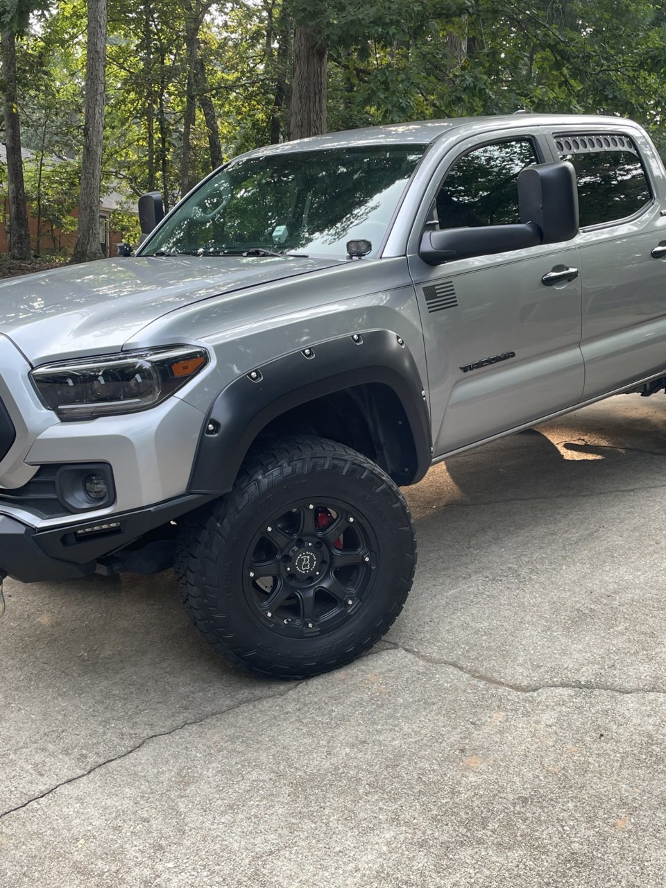

    I’m just impressed that you got the Ram HD tow mirrors to look almost natural on your truck. Very nice.

    Taco don’t deserve that
    *nvm, just read last sentence of your post. Cool window vents btw

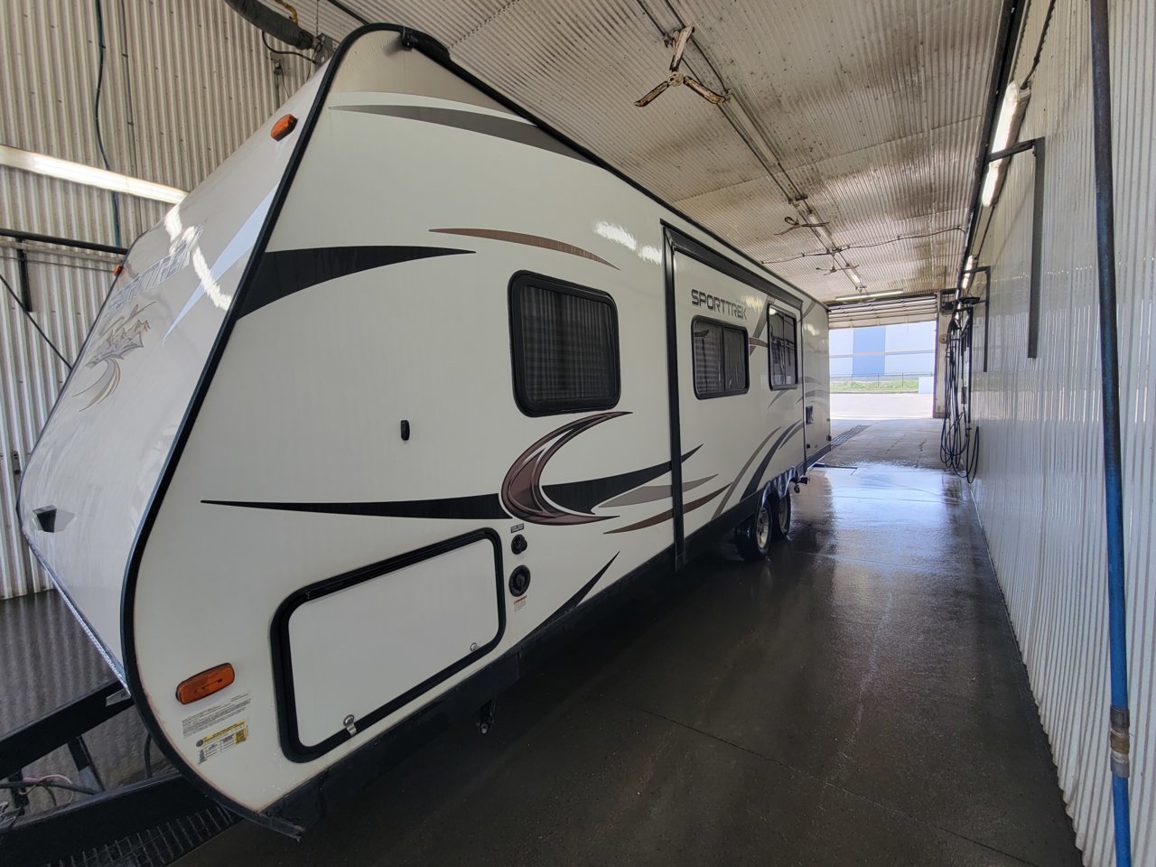

    Recently had to haul this pig around for a few days. ~ 6100 lbs. Not sure if you can get weight distrubtion or sway control on your trailer but it is a must have. And in fact stated in manual which I just found out.
    Also set you trailer brake gain to about 6 amps or higher.
    Surprisingly Taco is not bad and should be able to handle it but can't comment on the aftermarket stuff you have. Mine is completely stock, manual, and minor lift and 265 70 17s.
    Be patient. Very patient. And also use preimium grade fuel. Towed several thousand miles with 4000 and 5000 lbs all througout mountains and notice just a bit more crispness in shifts and power.
    All tricks Ive used and been happy with the truck. Also avoid serious grade at all costs lol. Throw the hazards on and be happy around 45 mph.
