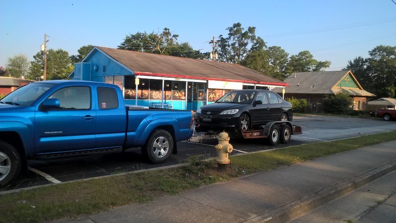

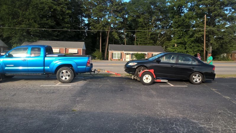

    You should be fine, I have a 07 V6 Prerunner with towing package and I towed my girlfriends 03 Civic (around 2500lb) once with a tow dolly(750lb) and once with an auto transport(2000lb). It was about a 400 mile trip both times, I cruised at about 60 mph and dont want to think about my gas millage. If you have the tow package you will have an oil cooler, tranny cooler, larger alternator, heavy duty hitch, 7 pin connector, and a plug and play brake controller.
    A couple thoughts for you - I understand that tow dollys are difficult to back up, different from other trailers, but I cannot say from personal experience. When you load up the car I would recommend putting something under the rear of the dolly to stop it from going down which jacks the trucks rear up, this is only when loading and unloading of course. Be aware that you are pulling two tons and to take it nice and easy with the gas. Also the truck is gonna sit nose high, maybe more so cause you have a lift, not sure about the lift part just a thought.

    A good thing to remember when using a tow dolly is that unlike a transporter (car trailer), you won't have the advantage of brakes back there. So, remember to give yourself extra room for braking.
