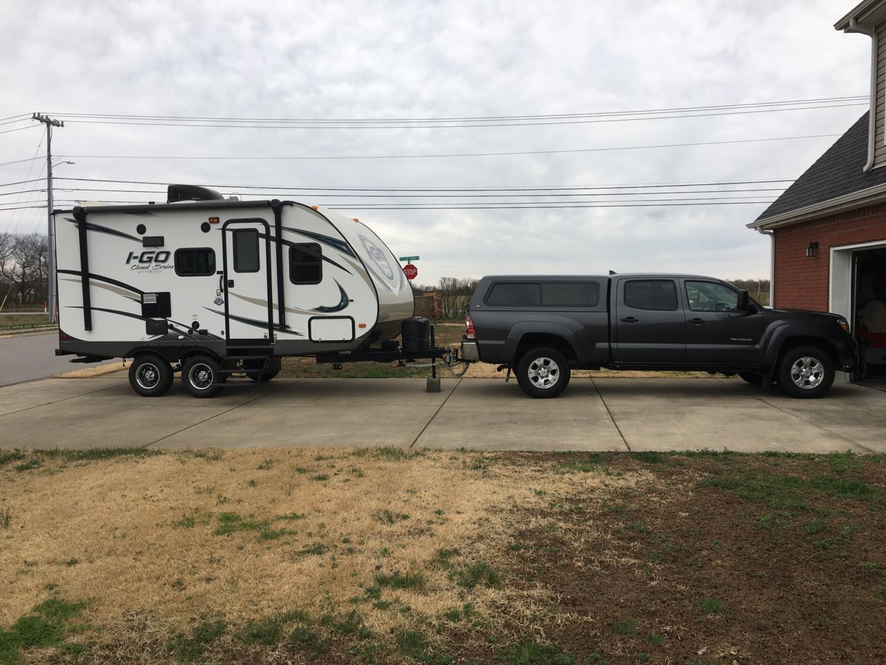

    My camper is right at 4200 loaded and ready to go. The truck pulls it well and I have gotten 10 to 12.7 mpg pulling it. Just take your time set your truck up right and you will be fineIMG_0041.jpg

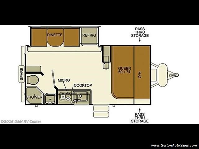

    We (wife and I) are thinking about getting a camper, I was looking for something like you have. What is the brand and model? Do you like it? Would it be big enough to sleep 4 ppl (we can never get rid of our grown kids...lol).

    It is an Evergreen 189FDS. However they went out of business July of 2016. Our was new and never titled when we bought it and we did not get any warranty with it but then most only give a 1 year warranty anyways. The box is only 15.5 feet long. If you look at it compared to my truck, the truck is longer than the box. We took it on an 1100 mile trip and the truck and camper are well matched. The camper had no issues at all during the trip and everything worked as it was supposed to. It is designed to sleep 3 but with the slide out it can easily sleep 4 or 5 but not sure about 4 adults. With the dual axles and the Anderson WDH there was no sway at all when we took it on the trip. We really like the camper and the way the inside is set up. 9f35930229_640[1].jpg
