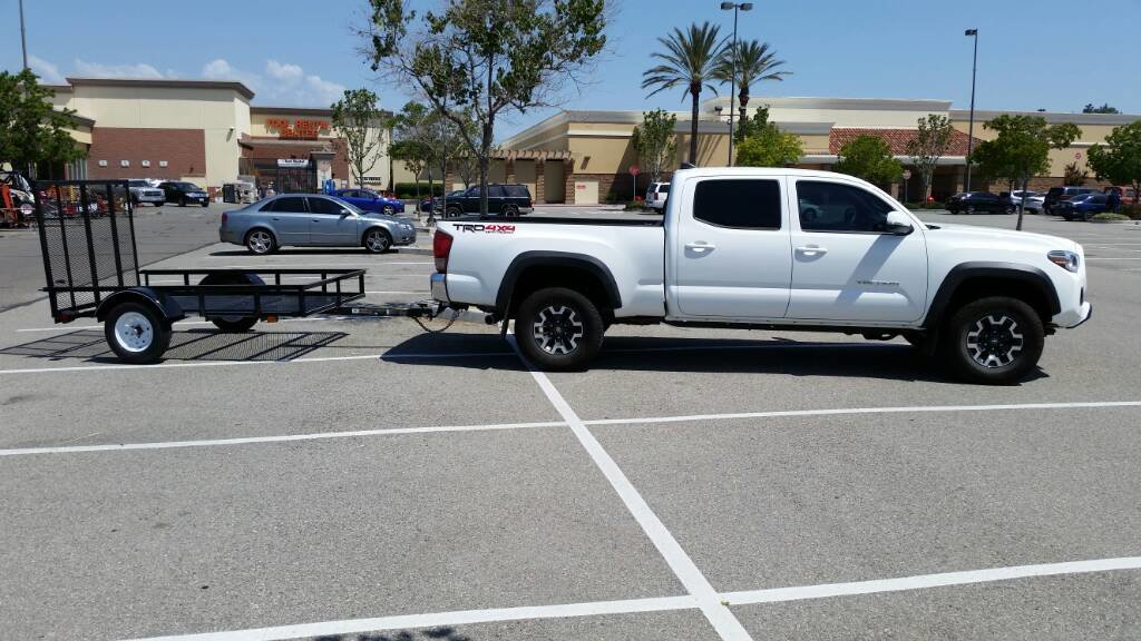

    The receiver on this truck is very high due to the off road capability. I had to get a 5.25 inch drop bar and still have the nose of my utility trailer sit high for loading the bed and trailer. Here is pic. It's a small trailer, though

    I have a 5x8 utility trailer using a 4" drop. Going to have to go with 5" or 6" to get it level.

    Thanks, and a special thanks for the picture. Looks like I was way off with a 2" drop :notsure:......5 or 6 seems more appropriate for my needs.

    You want the trailer and tongue no lower than level AFTER loading. Load weight and load position are a factor.

    Don't have the trailer yet, will be buying cheap from a friend---it's a 5x8 and looks very similar to the one in Eric's picture. Height to middle of receiver hole is 17.5".
