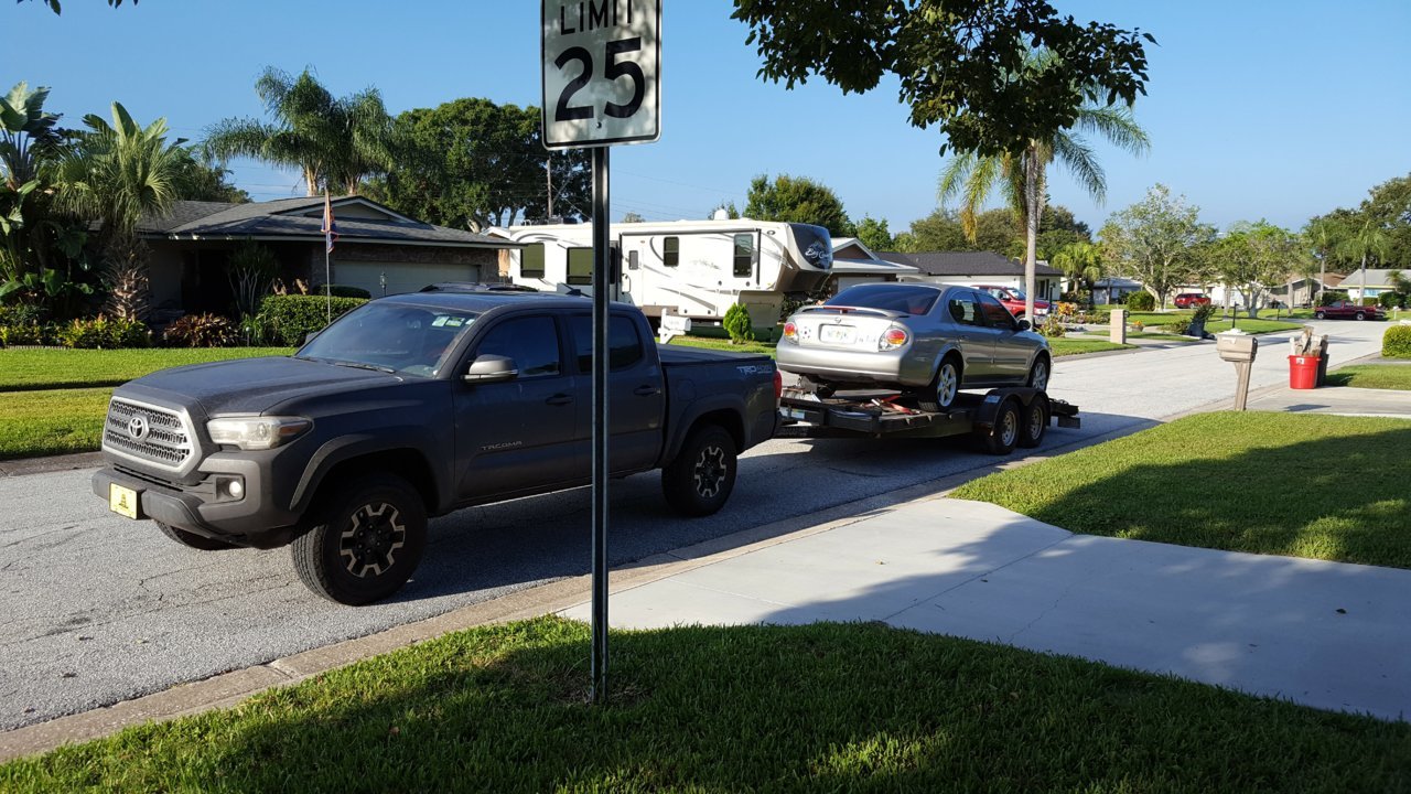

    My 6MT with stock everything tows this load up and down this incline just fine.
