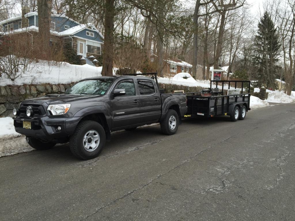

    I took a video earlier while climbing a big hill on I80 in NJ while towing my trailer home from PA.
    My trailer weighs 1800 LBS. In the trailer I had my 700 LB wood splitter. In the back of my truck I had another couple hundred LBS of chainsaws and tools.
    8B31AE87-E91F-48F6-982F-A14BAC5225D8_zps_62dbb5173f106909686608a86451293af63f4b5a.jpg
    Here's the video. http://s870.photobucket.com/user/Mi...-7670F212246B_zpsdwosv510.mp4.html?sort=3&o=0 Started up the hill in 5th, shifted down to 4th at 192*. As you'll see, the trans temp dropped quickly as soon as the torque convertor locked in 4th. This is all while maintaining roughly 65 MPH
    "TF1" is the temp at the pan
    "TF2" is the temp at the torque convertor
    I'll let you decide by the video if you think you need a ScanGauge, or another way to monitor trans temp, or what gear you want to tow in.
