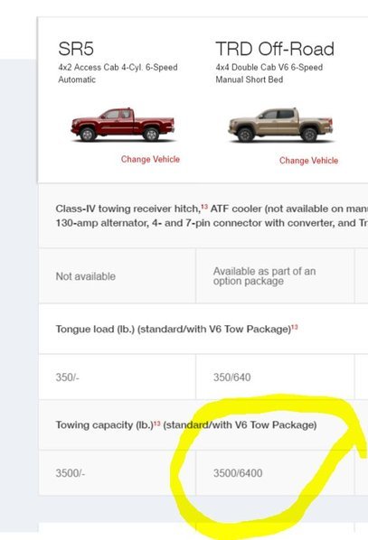

    from what I have found it sounds as though 3500 is the towing capacity of the manual transmission truck. The additional capacity on the auto is only added when you have the trans cooler. Have you found other documentation that states otherwise?

    That is not true. Towing capacity is 6400 lbs on the manual + tow package. It is 3500 without tow package.
