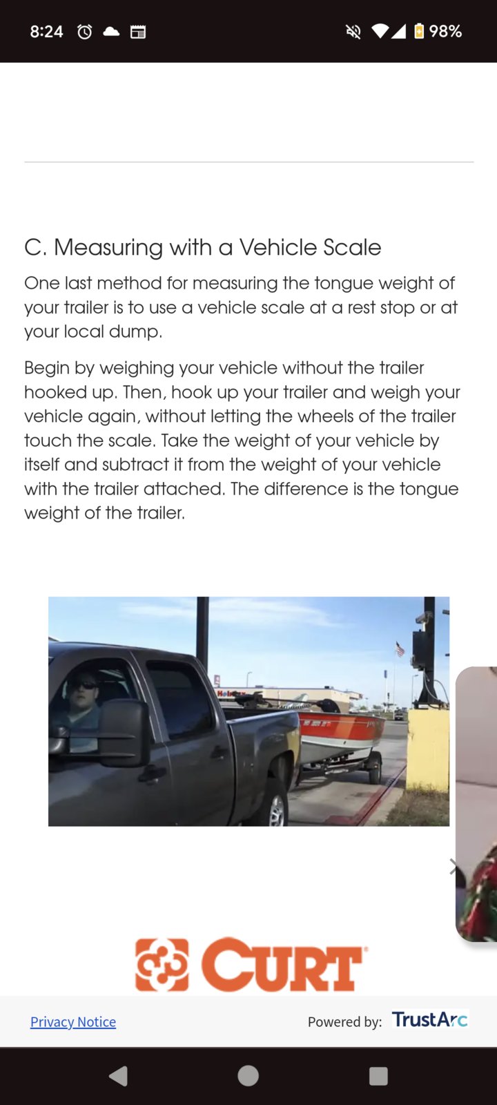

  19. Jan 20, 2024 at 8:25 AM
    #19
    Popcornh
    Popcornh [OP] Active Member
    Jan 18, 2024
    #441915
    36
    2019 TRD sport
    So I found an article that says this... Do I have to take the weight with everything out of my box or should I do this step while my.truck is loaded?
