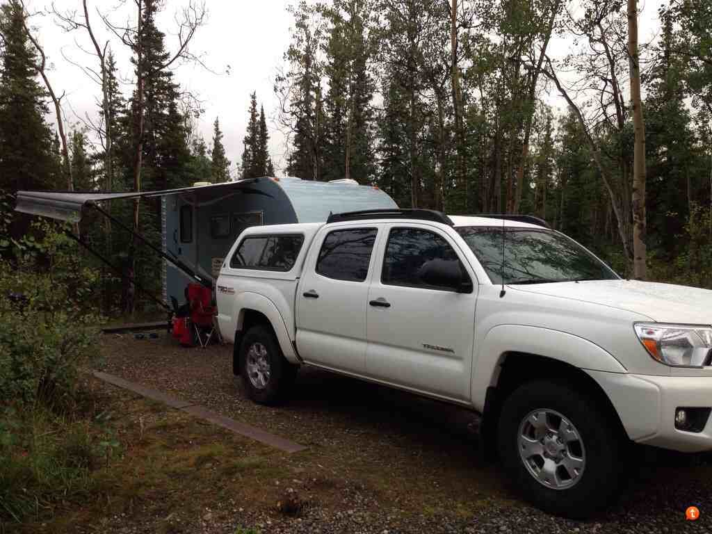

    In a few months I will be driving from Alaska to Missouri. Yes this is going to be one heck of a road trip. I will be towing my camplite 13QBB travel trailer too. I probably will get the oil changed in the spring but what else can I do to prepare my Rig for the journey and not kill it?
    My Rig is a '12 DBSB V6; picks for clicks:

    I don't really think there's really a whole lot you can do, but I'm also not a towing expert haha.
    That camper doesn't look to be that heavy, I think the truck will make it just fine! Have a safe trip!

    Here are some specs I grabbed from their website:
    Box Length 13'-0" Dry Weight *2,350 lbs
    Overall Length: 16'-6" Load Capacity: *650 lbs.
    Overall Width: 7'-0" Hitch Weight: 170 lbs.
    Height w/AC: 9'-6" Grey Water: 27 gal.
    Tire Size: 13" Black Water: 14 gal.
    GVWR: 3,000 lbs. Fresh Water: 20 gal.

    camper looks pretty light so weight shouldn't be much of an issue.
    A couple of common sense things:
    1. Towing mirrors (didn't see any in the pic)

    Yes tools are a must! An extra trailer wheel would be good too. I have been towing this TT for the last two summers and after adjusting the mirrors to view the dead space I don't think I need towing mirrors.
