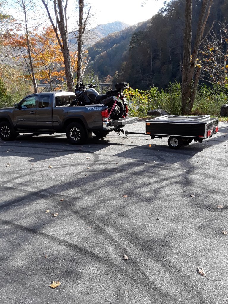

    I've hauled my Yamaha Super Tenere in my Tacoma many times.
    Bike weighs about 550 lbs.
    I always remove the side cases to make it easier to manage.
    You need a ramp and tie downs rated for the proper weight. Also at least a 6' long ramp.
    Using an incline also helps reduce the angle of the ramp.
    Don't try to ride it up the ramp. Put it in gear and walk it up using the clutch.

    I've hauled various bikes in the back. I have the six foot bed. The heaviest, and largest, was my BMW R1200 GS.
    I use a front wheel chuck similar to this one:
    https://www.amazon.com/dp/B004J6QKEQ/ref=cm_sw_em_r_mt_dp_KP2C046BCX42PM2R5MPH
    Between the weight of the chuck, and the fact that it's sitting on the bed mat, the front wheel isn't going anywhere. The rest of the bike is strapped down has you normally would when hauling a bike. This setup has been rock solid for me.

    I tried loading an intruder 1400 in the back of mine one time and the back wheel was pushing the tailgate in pretty bad. Probably could have made it work with some more support under the back wheel, but ended up just renting a trailer to be safe.

    Suggest a single rail motorcycle trailer.
    Like:
    Ace Single motorcycle trailer
    Kendon has a single rail folding.
    These are just 2, many others exist.
    These are lightweight trailers specifically built to carry a motorcycle. Loading one of these would be much easier than loading into the bed. Tie down would be easier too.

    Sportbike, no problem. I haul them on the regular in a short bed. Cruiser, no way. Three huge issues: bed height, wheelbase and payload.
    I have 2x 9 foot ramps and it’s still a little sketchy getting a 400 lb bike into the bed, especially after riding all day. I can’t imagine almost doubling up on the weight and mass AND increasing the load height.
    Your Softail is probably 700lb+. Payload on our trucks is in the 1000lb range depending on trim (check your door sticker) minus the weight of any aftermarket parts. You’re probably going to exceed the payload once you add people, gear, etc.
    Finally, the wheelbase on your Harley might put the wheel on the edge of tailgate or even past it.
    I’d say trailer as well despite the fuel cost.
