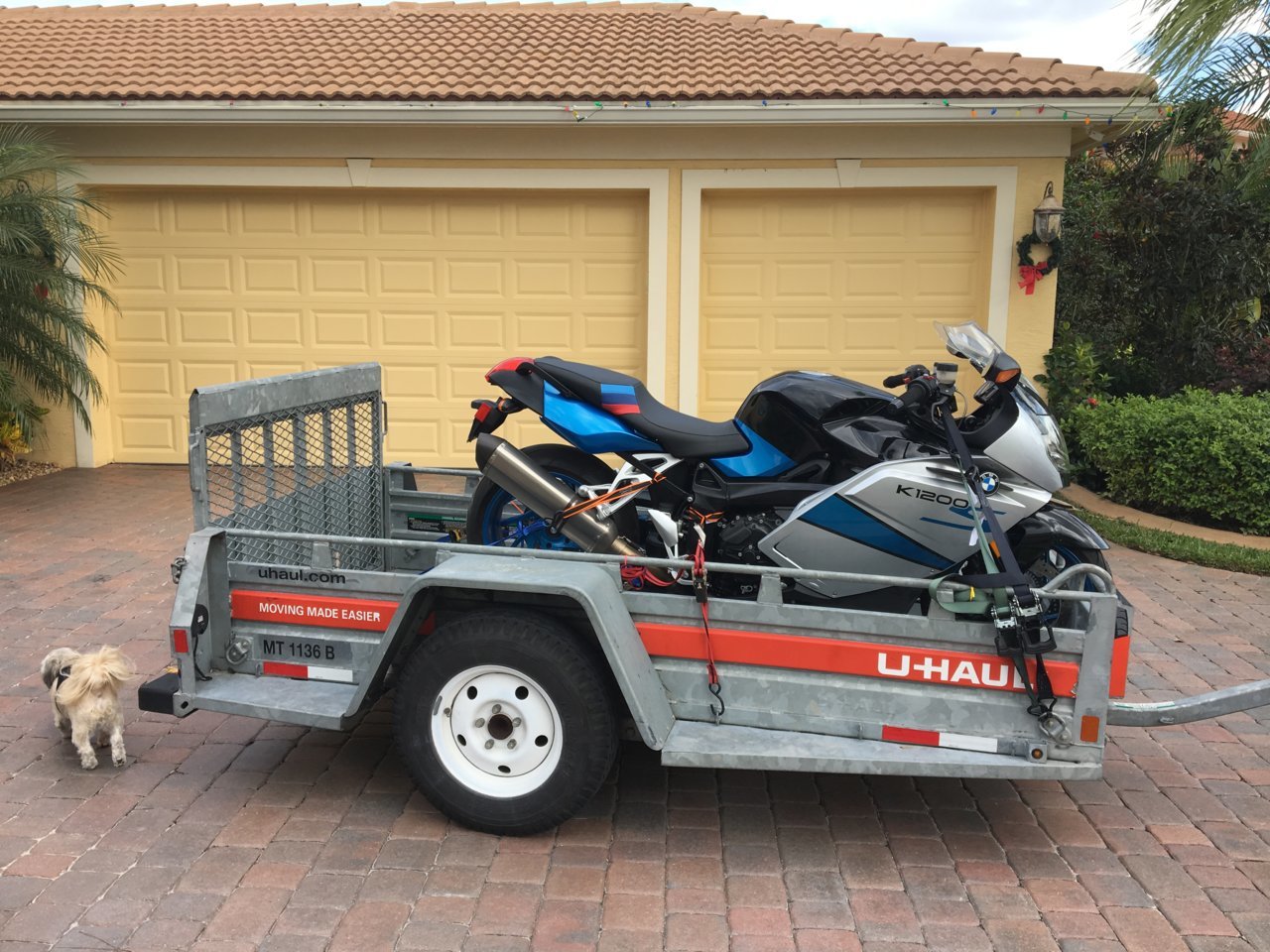

    Did this for my 4 hour trip into the keys. Worked fine and I’d rather load it into the trailer than risk dropping a bike while loading it into a pickup with a female and a bulldog as helpers. Dogs don’t really help with bike unloading.

    Don't cover a bike on an open trailer, the wind whipping the cover can damage the paint.

    1. Why cover a bike in an enclosed trailer?
    2. How does the wind enter the enclosed trailer to whip the cover?
    :p

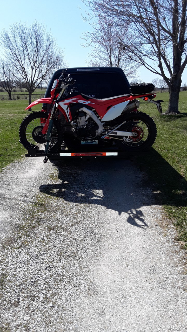

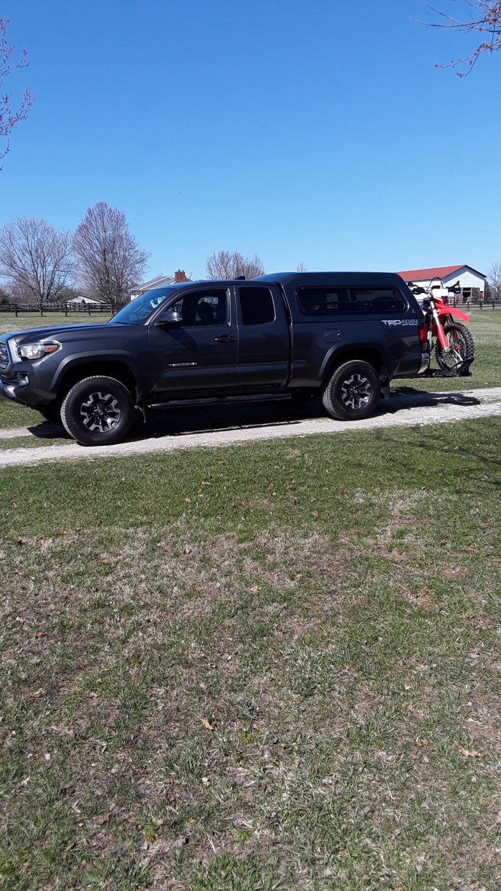

    I use a 600 lb rated hitch carrier to haul a 300 lb motorcycle. The carrier weighs 100 lbs so 400 lbs on the hitch.
    In stock trim the load resulted in about
    1 3/4" of sag measured at the rear wheel up to the top of the wheel well.
    While it wasn't terrible to drive it did result in a "nose up" condition.
    I added the Roadmaster Active Suspension system which lifted the rear of the truck about 1 1/2".
    Now with the bike on the hauler the truck sits almost level with about 1/4" of sag.
    I also added lights on the hauler.
    Not the best pictures.

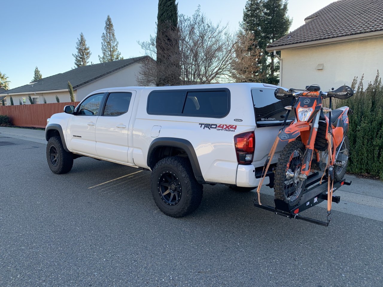

    Another vote for a hitch carrier... little to no sag as well.

    Hitch carriers are great for dirtbikes and light, compact sportbikes, but a Softail is a whole different thing. Too heavy and too long for a hitch carrier.

    Agree
    Probably 450 lbs max motorcycle weight for a hitch carrier.
    I've seen custom designed carriers but they were also mounted on 3/4 ton vehicles.
