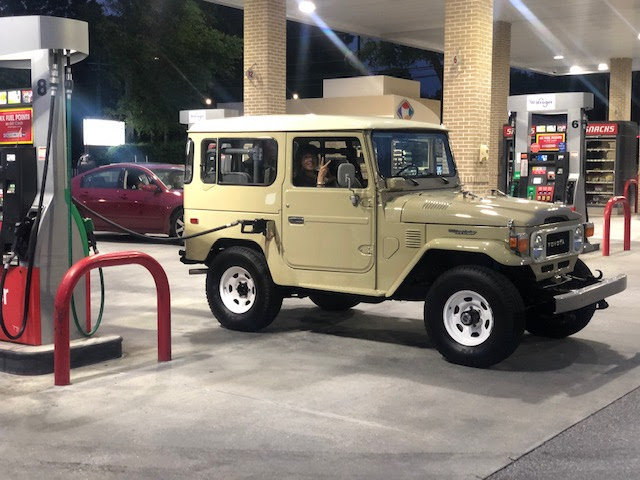

    First one is a'commin'
    Been reading and reading and reading...then watching and watching all possibly YouTube clips. At some point, most of these YouTube channels are doing this for shock factor ("Let's see how much our Gen 1 Tacoma can tow!"). None of this is helpful...but I have read over a few times the The Tacoma Towing Bible by the amazing @maverick491 . But I am still scratching my head a bit. With that being said - can someone give me some advice here. I just need some real-world validation before I go down that path.
    What I am trying to so: Tow my 1981 FJ40 from GA to FLA for an event (about 500 miles one way).
    What I have: 2015 Prerunner 4x2 4.0L V6 with factory installed tow package/class IV, Bilsteins, etc.
    How I want to tow it: The standard Uhaul auto transport trailer that you can find pretty much anywhere.
    My Taco GVWR is: 5400lbs
    Added extras on my taco: Full rack, running boards 100lbs
    Uhaul Trailer is: 2200lbs (empty), 5290 max load
    My FJ40 wet weight (with no cargo) is around 3500lbs
    Hitch weight: Maybe 50lbs
    Max Tongue weight: unknown
    The more I look at these numbers, its creeping up there to the max towing for this 4.0L, which is starting to tell me it may be too much for steel trailer+old FJ40.
    Thoughts?

    Your 40 looks great! I've done the same thing with my 2005 Tacoma (4x4 with the towing package) towing my old '73 FJ40 using that same trailer ~ 200 miles round trip. The brakes weren't working on the first trailer so I went back and got another one. In my case I made sure a) I was in no hurry and b) drove during times where traffic was light to minimize quick stops and was good to go. It's not something I'd do often but it was fine.

    I think you're borderline.
    In the real world around 4500-5000 lbs is about as much as I'd want behind my Tacoma. If you're numbers are accurate you're at 5700. But you have a couple of things in your favor. You won't be towing at any altitude over 1000' and there won't be any hills. Some rolling terrain for the 1st 50 miles then basically flat.
    Your 2wd Pre-Runner will have a little more payload than a 4X4 which will help. A lot comes down to how much weight you will have in the Tacoma. If it is just you with little or no other cargo then I'd probably try it. But if you're taking 1 or 2 passengers and will have several hundred pounds of cargo in the truck probably not
    You might want to actually weigh the FJ. If it proves to be significantly heavier than your 3500 lb estimate you might want to reconsider.

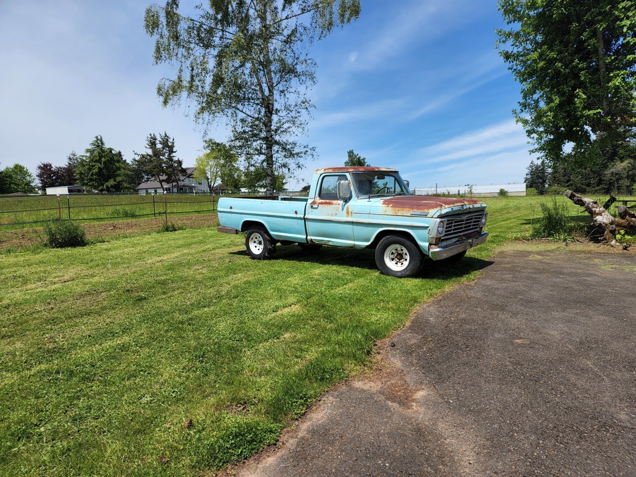

    don't tell U-Haul what you're towing. my 09 Tacoma was going to bring home a 1995 2wd single cab Tacoma, and they wouldn't rent me a transport trailer because it wasn't rated for the weight of that.
    but on an alternative note I've brought home a 1967 F100 with my Tacoma on a 2wd dolly telling them i needed to bring a corolla home.
