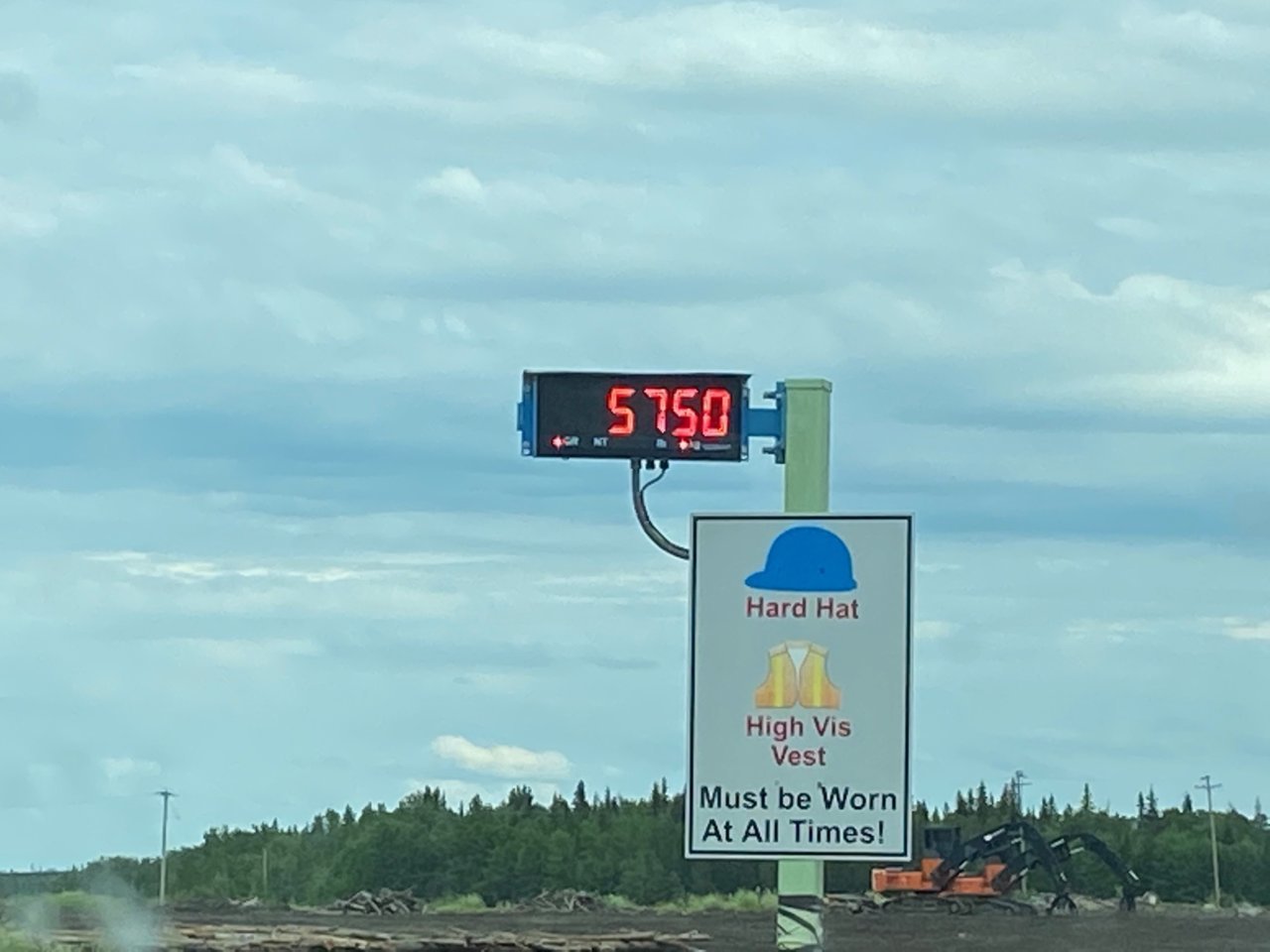

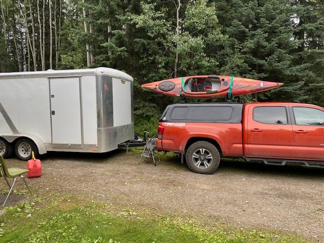

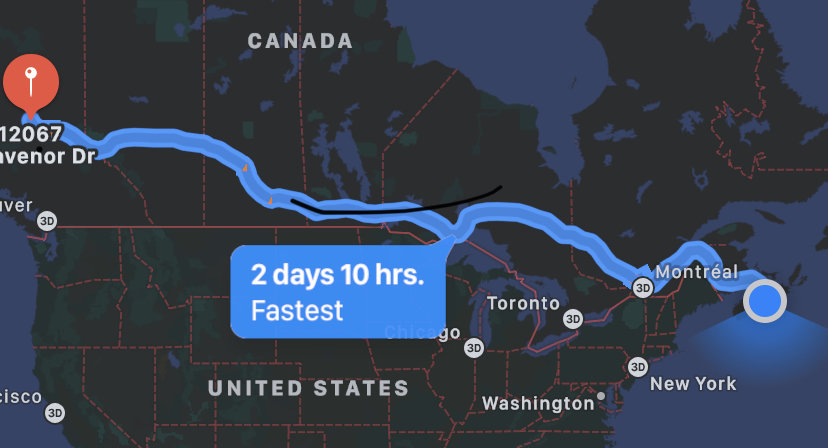

    lol yup, those are kilograms , so 12650 lbs for the truck and trailer. 2016 TRD sport longbox. Not saying you should do it, but saying this is what we did over 8 days.

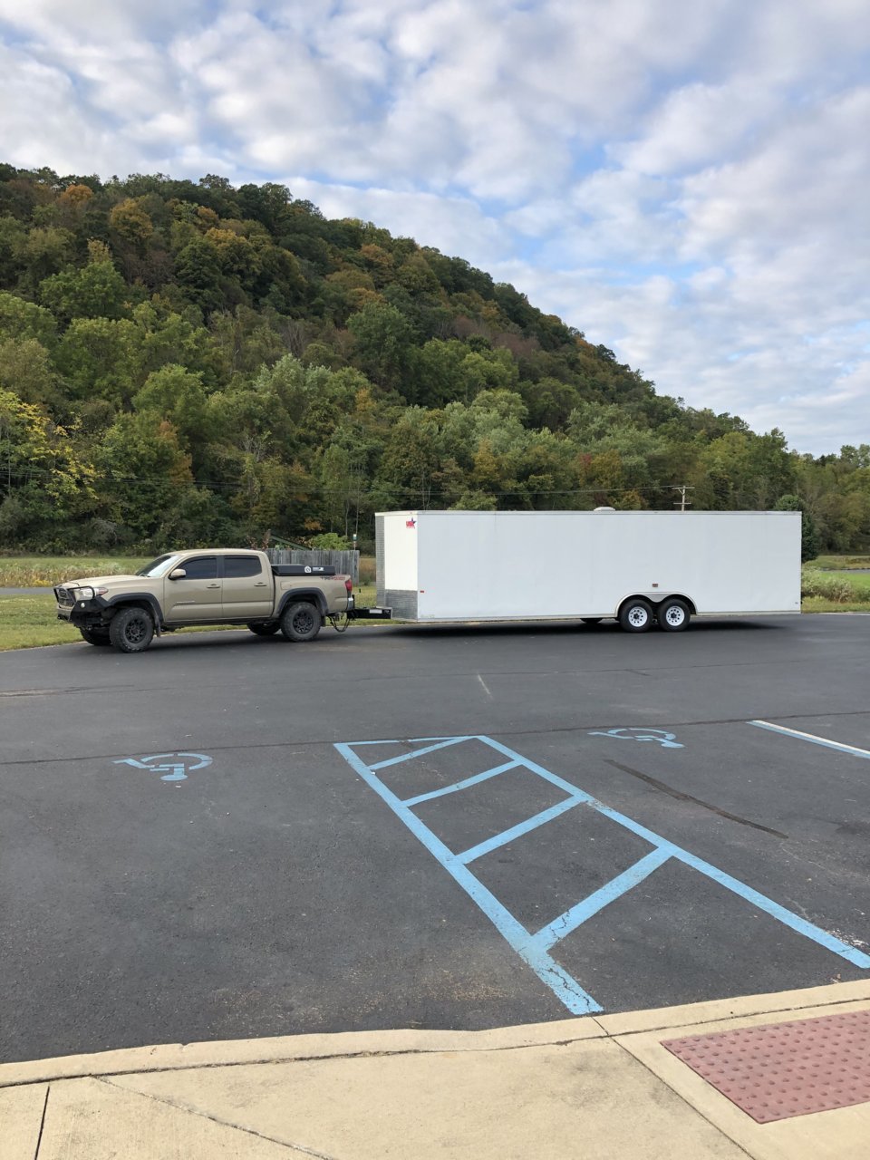

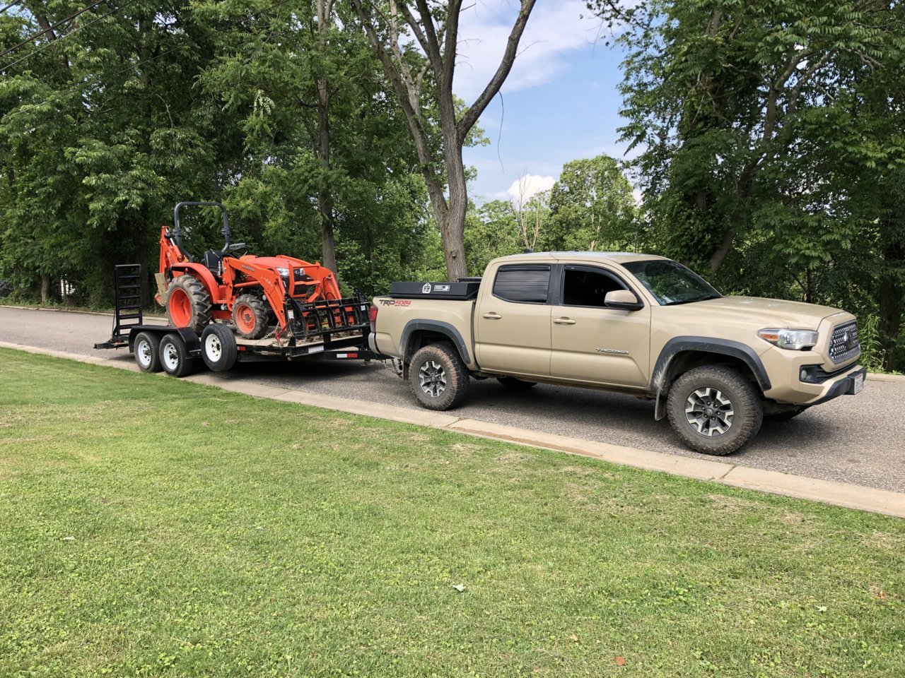

    You’ll be fine towing, just watch taking off on hills with the MT. I try to avoid steep inclines or plan a route around them. If I get into a situation of taking off from dead stop on a steep hill I’ll throw it in 4 low temporarily.
    Get yourself a good trailer brake controller. Around here you can find a cheaper used dual axle car hauler for around $2k or so. If clearance on the Subaru is an issue you could get a tilt deck.

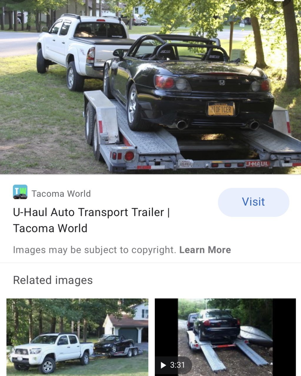

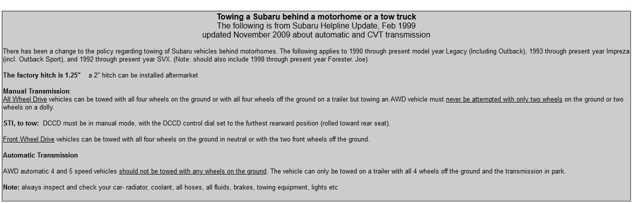

    I saw this on TW see photo

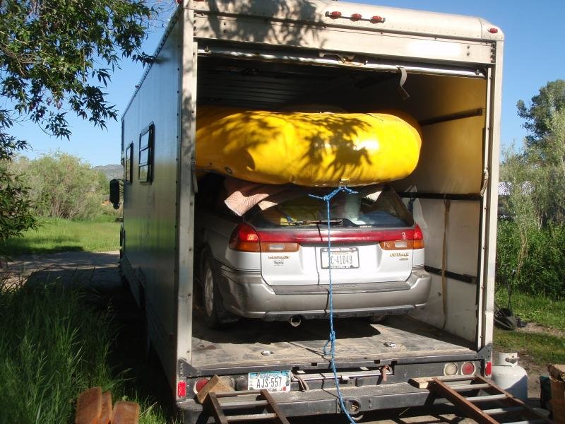

    You could save the wear/tear on the Taco and rent a UHaul every time...

    When you rent a Uhaul vehicle (not a trailer, but something with an engine) they charge by the mile... doing track events using this method would get expensive quickly.

    Pretty sure he wasnt serious.

    Is your Rally Car an auto?
    I mean, I understand exploding diffs and shear, and the 4EAT, I've got to pull fuses if I ever get a flat with our Forester;
    But if your STI is manual and you dial back your DCCD you can flat tow it. I'm sure you can find the same threads on NASIOC that I see..
