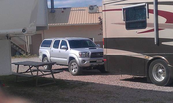

    I was all excited when I woke up to seeing the Taco this morning. I havent talked to the people yet but my mom seems to think its two lesbians since she seen two women and their from CA
