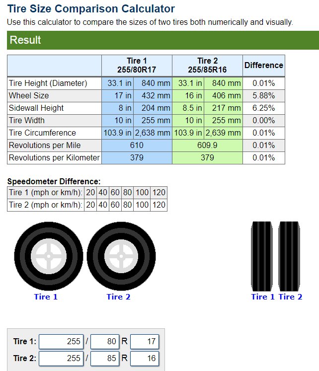

    Only difference is going to be the sidewall height, diameter is the same.
    16" wheel will have more sway in corners and absorbs bumps 6% better.

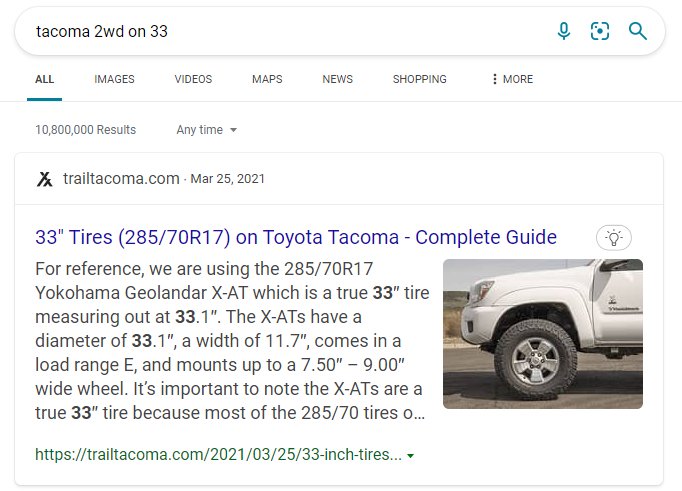

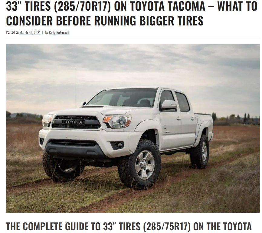

    You did not mention your Tacoma specs, this should help:
  16. Aug 9, 2022 at 4:08 PM
    #16
    EarthCruzn
    EarthCruzn Well-Known Member
    Jun 15, 2022
    #399476
    373
    Florida
    2022 TRD V6 4WD Manual 6 Speed
    DCSB SPORT
  17. Aug 9, 2022 at 4:16 PM
    #17
    EarthCruzn
    Jun 15, 2022
    #399476
    373
    Florida
    DCSB SPORT
    This web site will not allow the link to show (competition)
    Search this
  18. Aug 9, 2022 at 4:17 PM
    #18
    saint277
    saint277 Vigilo Confido
    Apr 14, 2020
    #324724
    2,294
    Those are 285s not 255s
