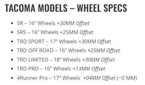

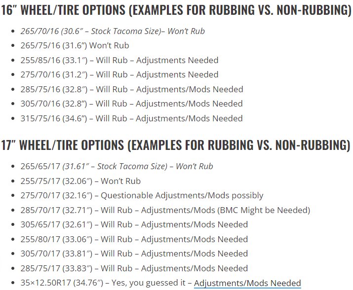

    DCSB SPORT
    Does this look correct?
  8. Aug 10, 2022 at 4:35 AM
    #28
    Rock Lobster
    Rock Lobster Thread Derailer
    Dec 14, 2018
    #275833
    13,448
    Dee Eff Dub
    I drive a Miata.
    For the most part yes. Some people have shoehorned the upper part of that list by maxxing out caster on their alignment specs, but yes, from what I've seen, I'd agree with it.
