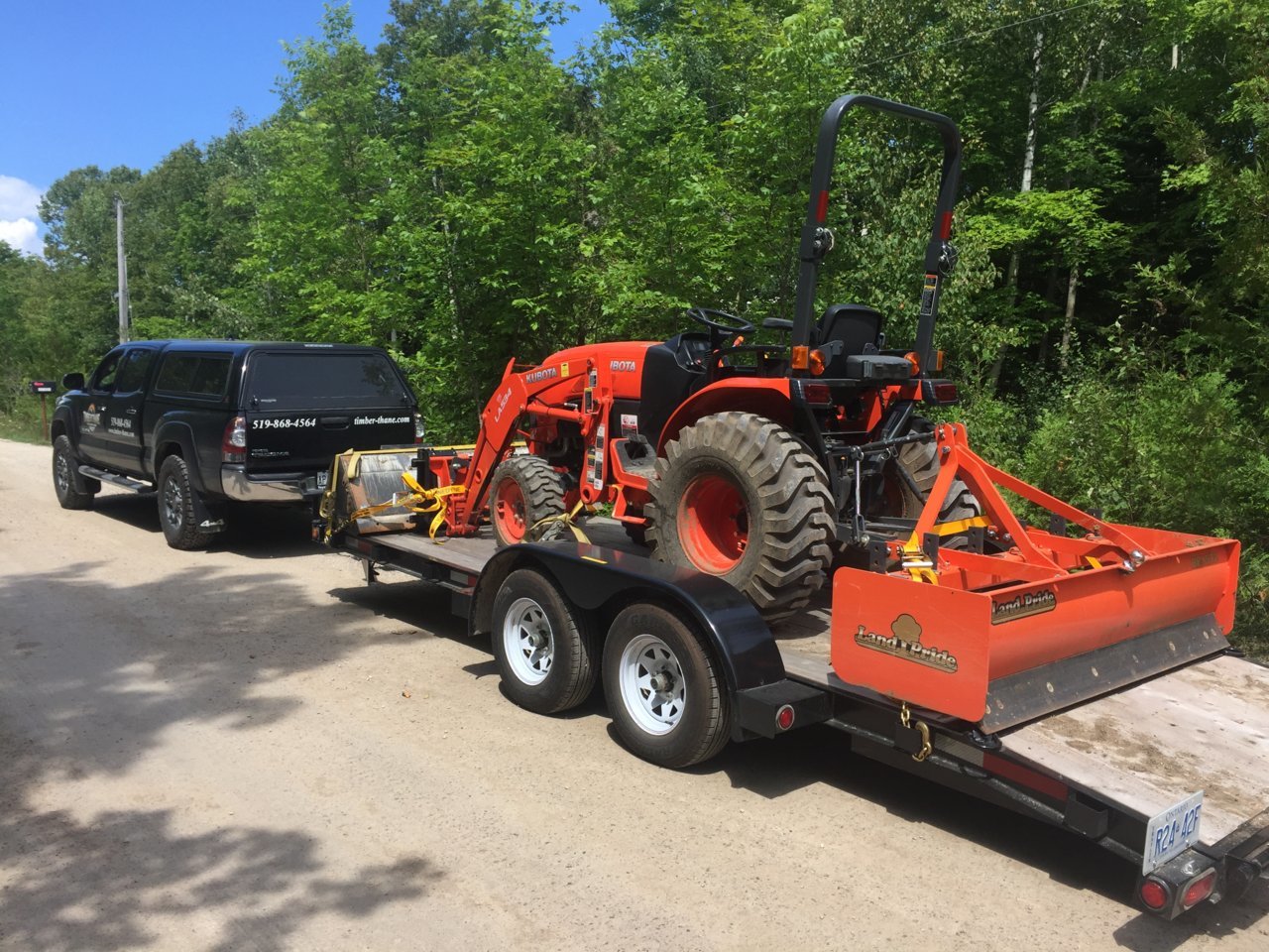

    Tocamas tow just fine within the boundries they are rated for. Why else would they put such numbers on the rating? IMG_3231.jpg
